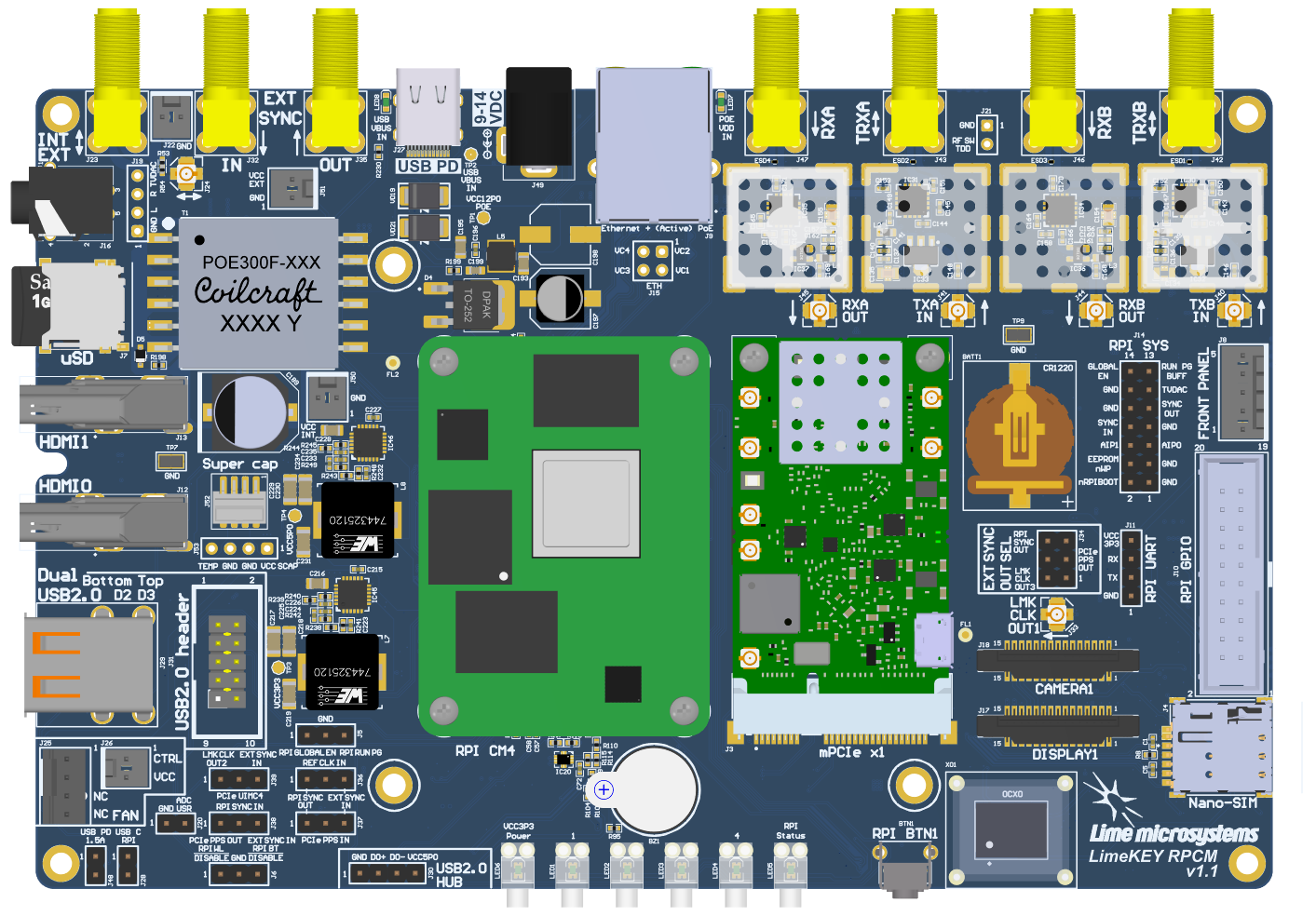

Figure 1: LimePSB RPCM v1.1 board top view
Figure 2: LimePSB RPCM v1.1 board bottom view

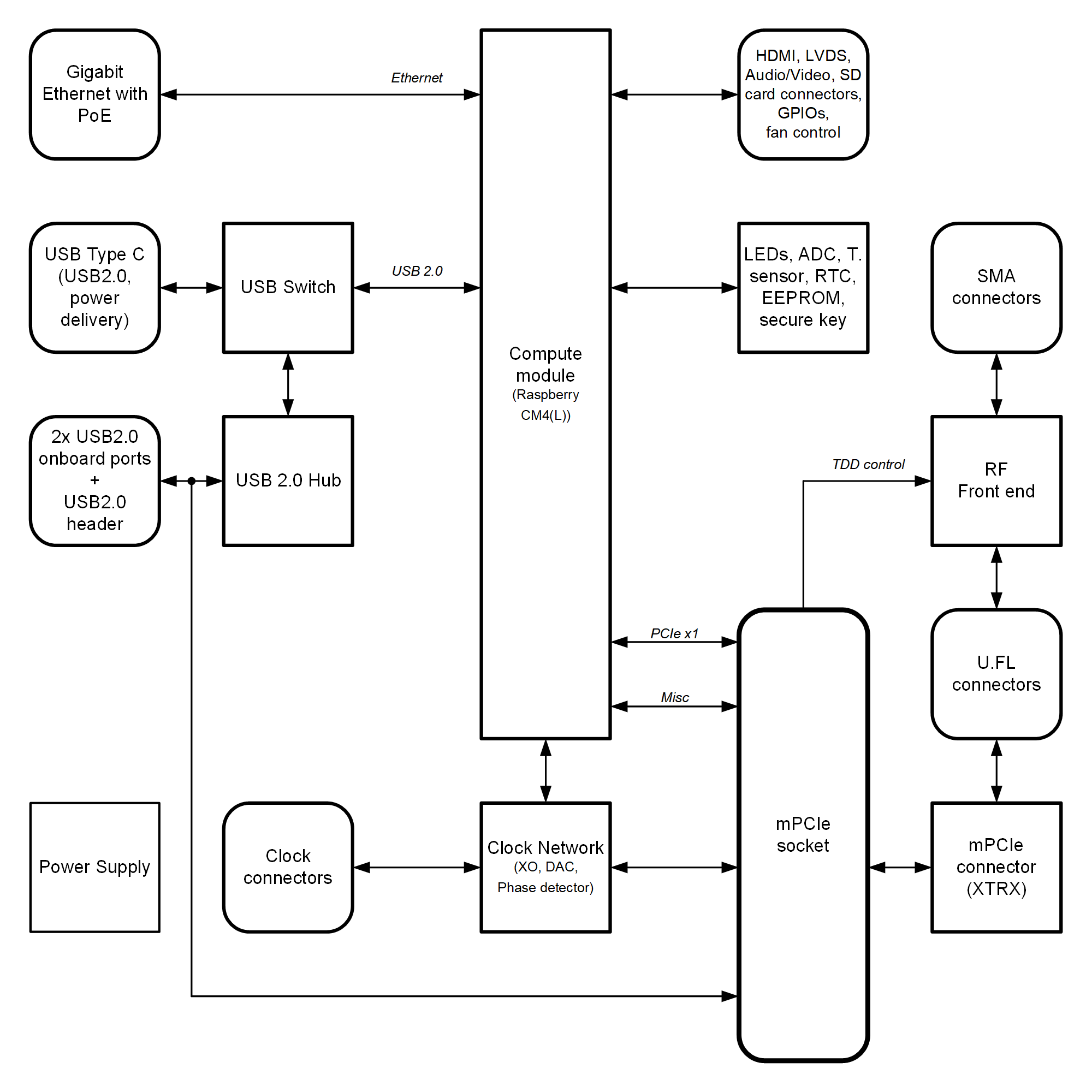

The heart of the LimePSB RPCM carrier board is Raspberry PI Compute Module 4 which may be used to transfer digital data between the CM4 and mPCIe board while performing data processing. The block diagram for LimePSB RPCM board is as shown in Figure 3.
Figure 3: LimePSB RPCM v1.1 board block diagram

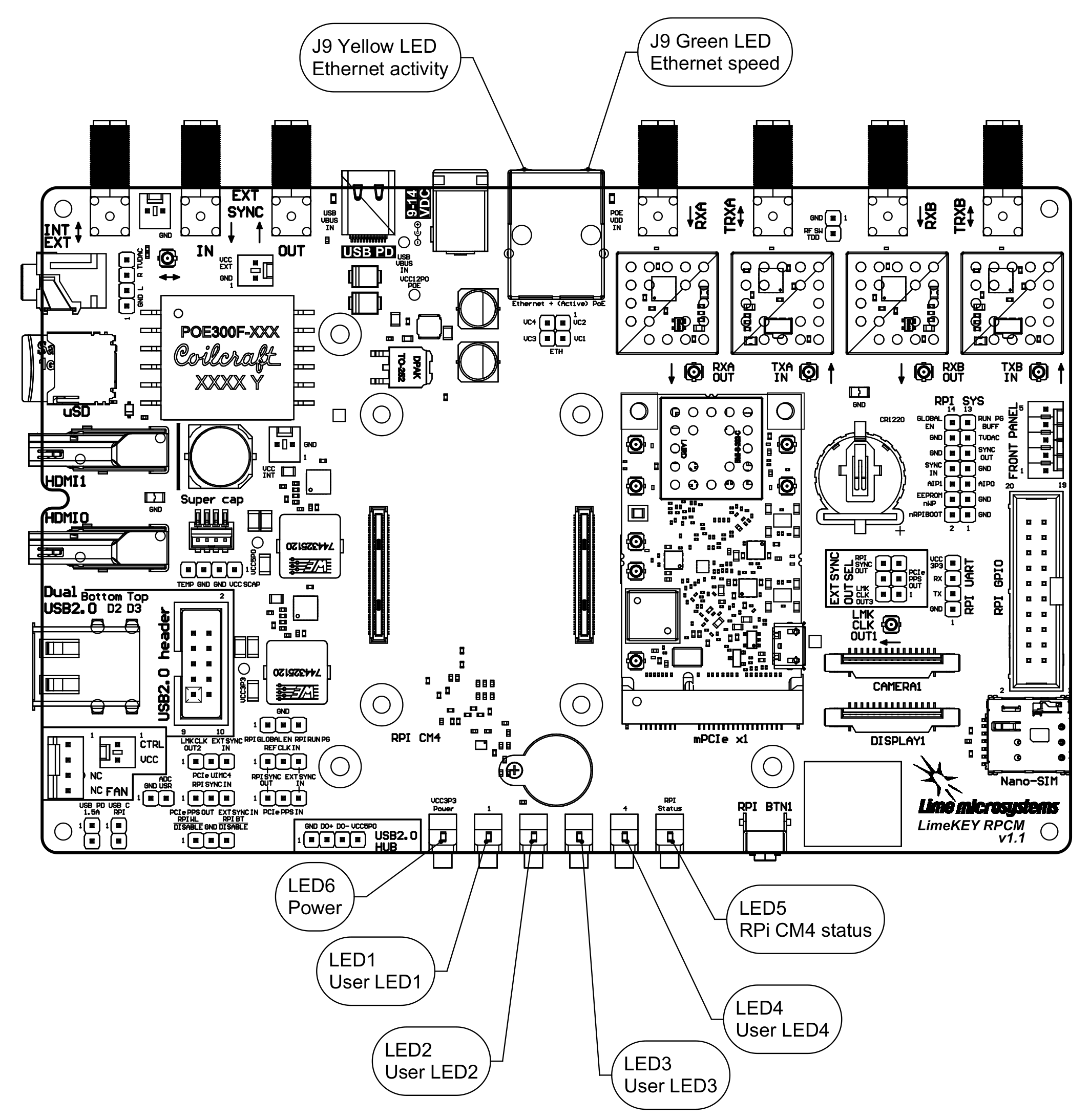

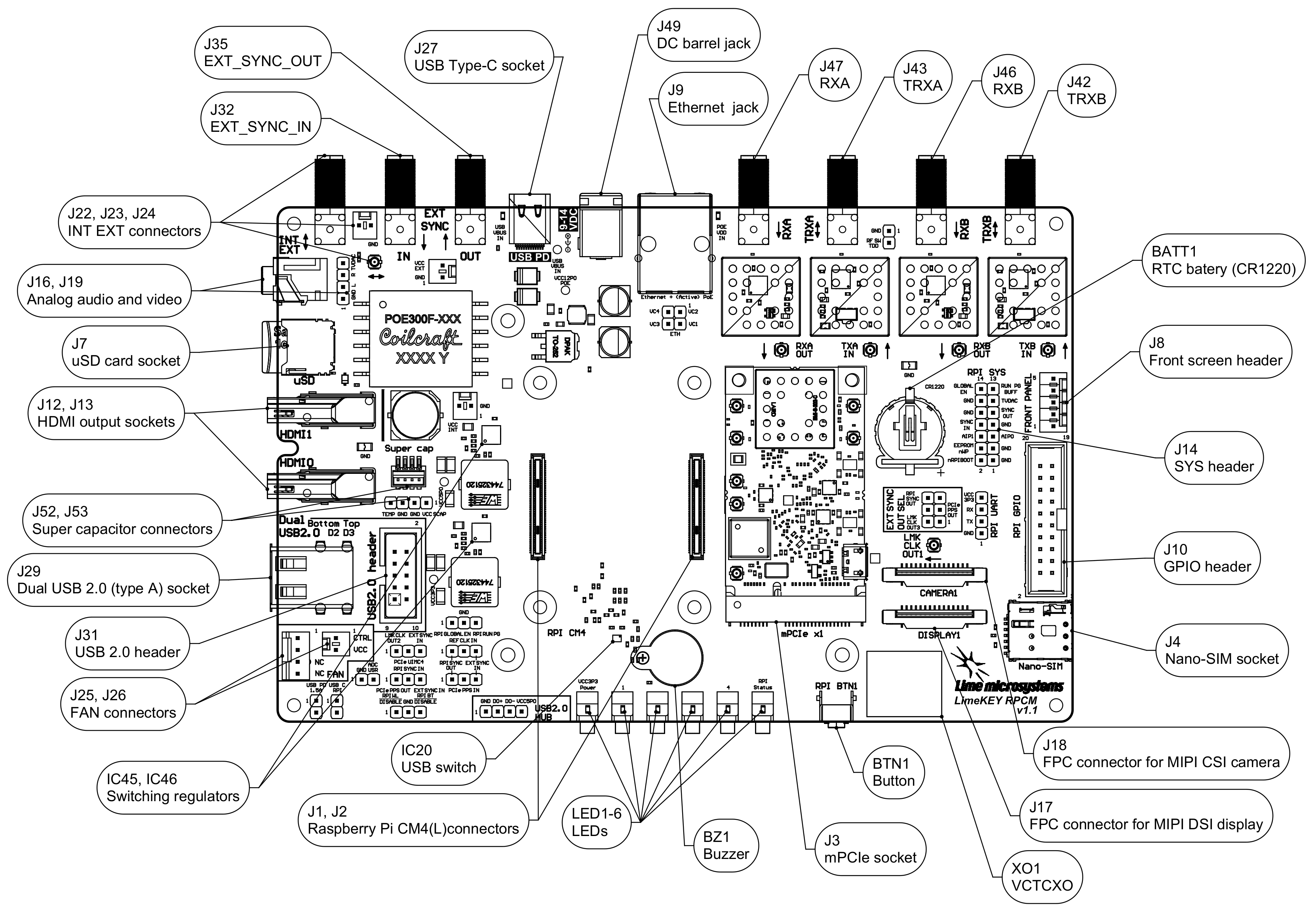

LimePSB RPCM board picture with highlighted connectors and main components are presented in Figure 4 and Figure 5.
Figure 4: LimePSB RPCM v1.1 board top connectors and main components
Figure 5: LimePSB RPCM v1.1 board bottom connectors and main components
Description of board components is given in the Table 1.

Configuration, Status, Setup Elements and GPIOs |
LED1, LED2, LED3, LED4 |
Red-green status LEDs |
User defined indication LED |
LED5 |
Raspberry CM4 status |
LED6 |
Green status LED |
Power indication LED |
J14 |
Header |
14-pin Raspberry CM4 SYS header |
J5 |
Header |
Power control and PG status |
J6 |
Header |
Wireless LAN and Bluetooth control |
J10 |
Header |
20-pin CM4 GPIO header |

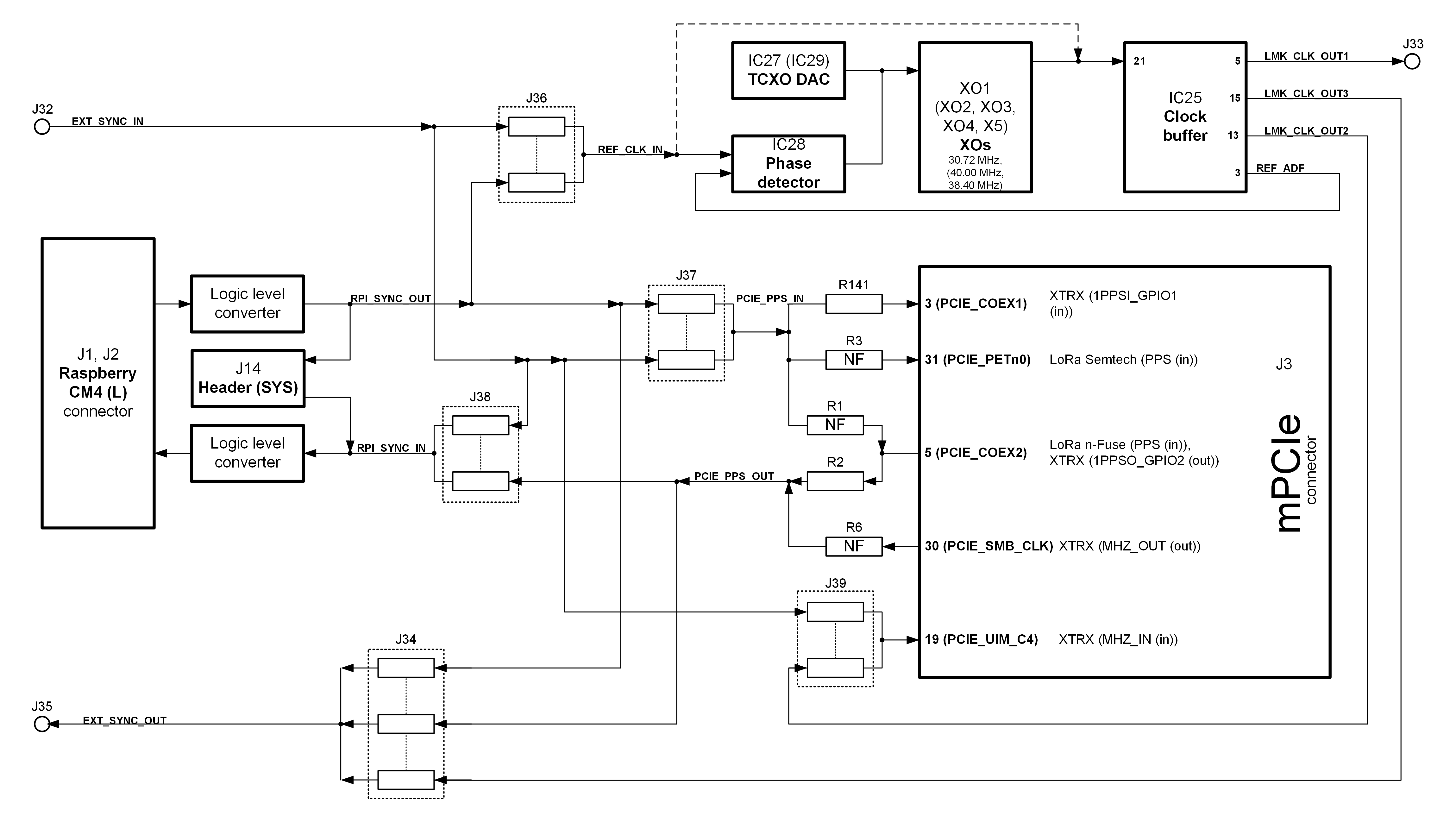

Clock Circuitry |
XO1 |
VCOCXO |
30.72 MHz VCOCXO |
XO2 |
VCTCXO |
30.72 MHz VCTCXO |
XO3 |
VCTCXO |
30.72 MHz VCTCXO |
XO4 |
VCTCXO |
40.00 MHz VCTCXO |
XO5 |
VCTCXO |
38.40 MHz VCTCXO |
IC27 (IC29) |
IC |
16 (8) bit DAC for XOs VC tuning |
IC25 |
IC |
Clock buffer |
IC28 |
IC |
Phase detector |
J32 |
SMA connector |
Reference clock input EXT_SYNC_IN |
J35 |
SMA connector |
Reference clock output EXT_SYNC_OUT |
J33 |
U.FL connector |
Reference clock output |
J22/J24, J23 |
Multiple |
Internal connector J22/J24 to external SMA J23 |

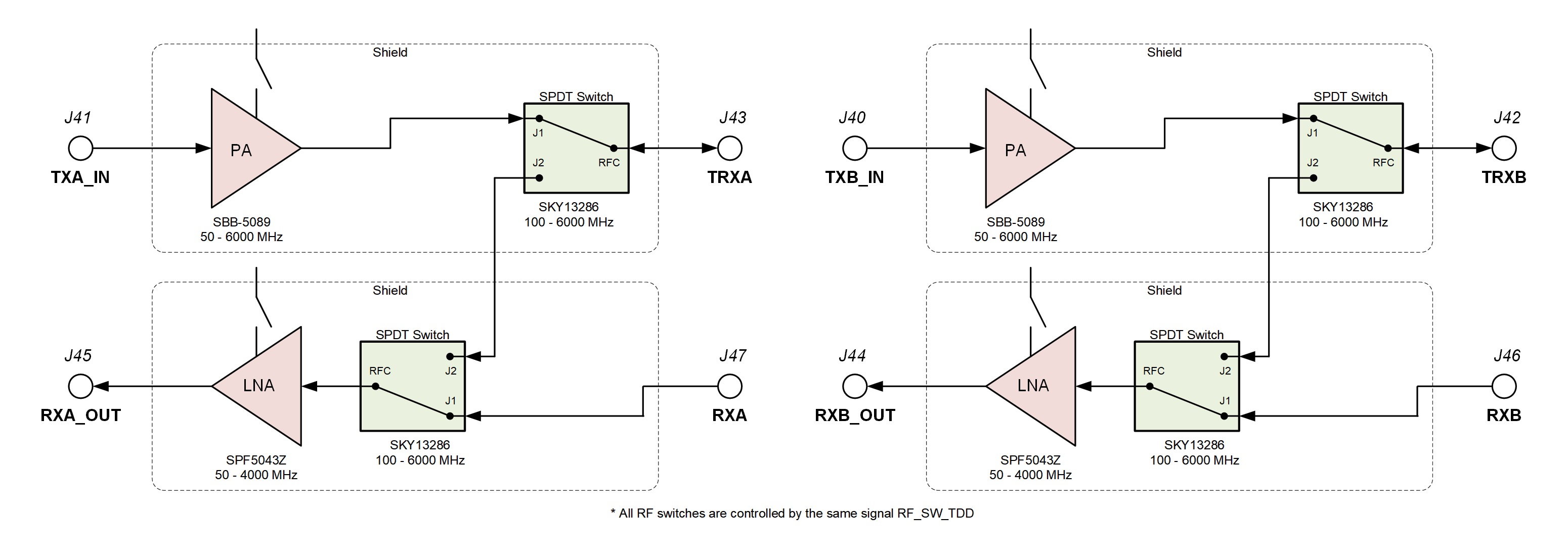

RF Front End
LimePSB RPCM RF path features power amplifiers, low noise amplifiers and SPDT switches as shown in Figure 6.
Figure 6: LimePSB RPCM v1.1 RF path block diagram
A single control signal (RF_SW_TDD) is used to control all RF switches simultaneously for both A and B channels to change between TDD and FDD modes as shown in Table 7.
Control signal (RF_SW_TDD) |
TRXA/B connected to |
Low |
TXA/B_IN |
RXA/B_OUT |
High |
RXA/B_OUT |
NC |
By default RF switches may be controlled from mPCIe expansion board pin 17 (via resistor R40). Optional control source may be RFFE TDD control header (J21) or CM4 GPIO6 (resistor R41 must be soldered).
RF path contains two types of connectors: board edge SMA connectors (J42, J43, J46, J47) used for external connections (antennas or cables) and U.FL connectors (J40, J41, J44, J45) used for internal connections (for example to connect to XTRX mini PCIe expansion board).
Signal frequency range of TX and RX paths are listed in Table 8.
Direction |
Frequency range |
TX |
100 MHz - 6 GHz |
RX |
100 MHz - 4 GHz |
More detailed RF path component parameters are given in Table 9.
Component |
Function |
Gain, dB |
Output P1dB, dBm |
NF, dB |
SBB-5089 |
TX amplifier |
20.5dB (850 MHz) 19.0dB (1950 MHz) 15.5dB (6000 MHz) |
20.5dBm (850 MHz) 20.4dBm (1950 MHz) 14.7dBm (4000 MHz) |
3.8dB (850 MHz) 4.1dB (1950 MHz) 4.6dB (4000 MHz) |
SPF5043Z |
RX amplifier |
18.2dB (900 MHz) 12.9dB (1960 MHz) 7.0dB (3800 MHz) |
22.6dBm (900 MHz) 22.7dBm (1900 MHz) 22.8dBm (3800 MHz) |
0.8dB (900 MHz) 0.8dB (1900 MHz) 1.5dB (3800 MHz) |
SKY13286 |
RF switch |
-0.7dB (1000 MHz) -0.8dB (2000 MHz) -1.6dB (6000 MHz) |
30.dBm (2000 MHz) |
LimePSB RPCM RF front end uses same design as Front End Adapter. For more information about the design check LimeSDR XTRX documentation

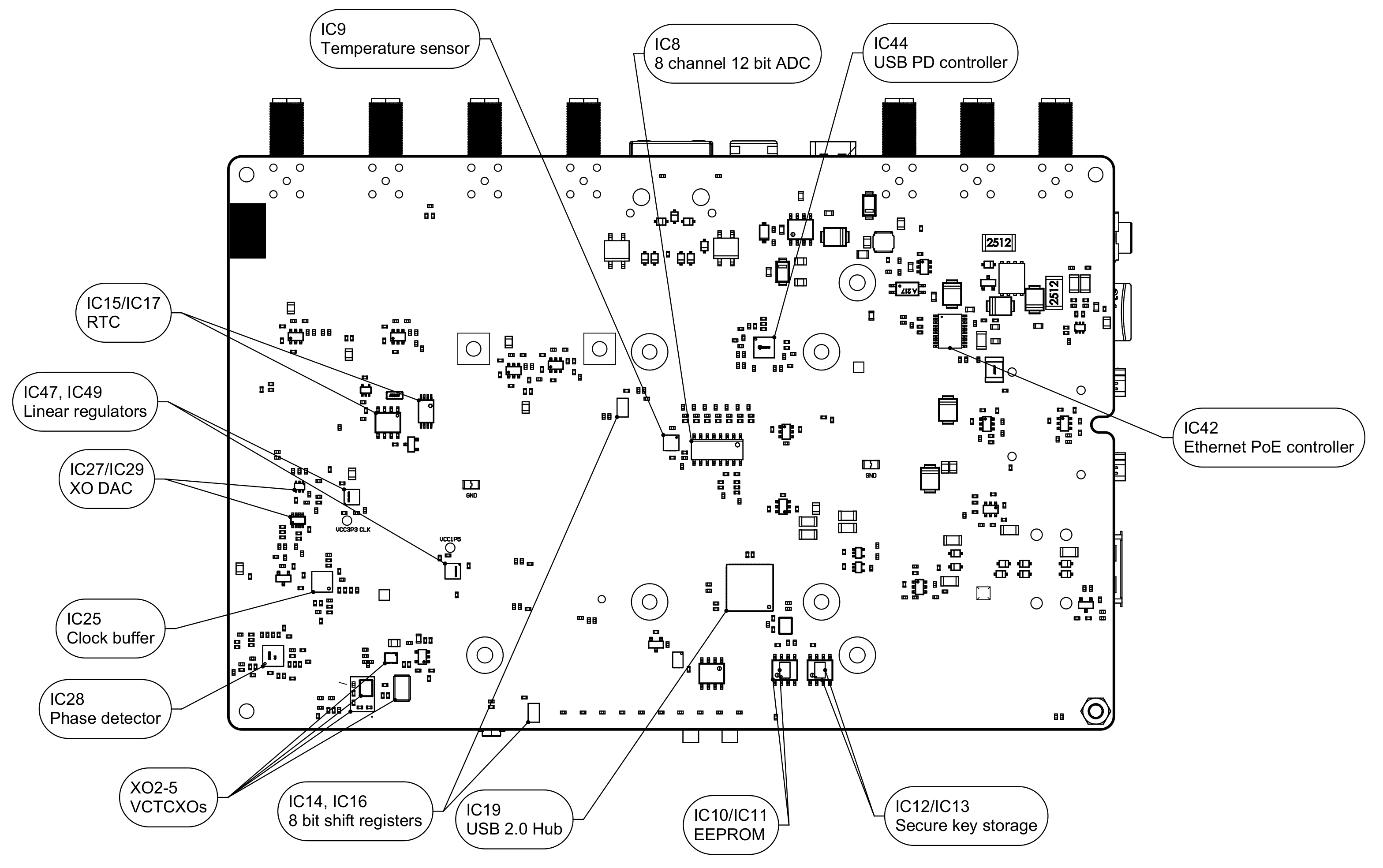

User Interface Components
LimePSB RPCM board features five dual colour (red and green (RG)) LEDs, one green indication LED and two Ethernet activity LEDs (yellow and green). All board LEDs are highlighted in Figure 8.
Figure 8: LimePSB RPCM v1.1 user interface components
Dual color LEDs (LED1-LED4) are connected to shift register (IC14). Their function may be programmed according to the user requirements. Dual color LED5 indicates Raspberry Pi status. Green LED6 indicates board power. These LEDs are mounted on the front side of the board.
Ethernet connector J9 has two LEDs: yellow and green. LEDs indicate wired network activity and speed.
Default function of LEDs and related information is listed in Table 11.
Board Reference |
Schematic name |
Shift register (IC14) pin |
Description |
LED1 |
RPI_LED1_R |
Q0 |
User defined. |
RPI_LED1_G |
Q1 |
LED2 |
RPI_LED2_R |
Q2 |
User defined. |
RPI_LED2_G |
Q3 |
LED3 |
RPI_LED3_R |
Q4 |
User defined. |
RPI_LED3_G |
Q5 |
LED4 |
RPI_LED4_R |
Q6 |
User defined. |
RPI_LED4_G |
Q7 |
LED5 |
RPI_STATUS_LED_R |
Green is connected to CM4 PI_LED_nPWR (Power On) and red is connected to Pi_nLED_Activity (Activity). |
RPI_STATUS_LED_G |
LED6 |
VCC3P3 |
Board power. Connected to 3.3 V power rail |
Ethernet connector J9 LEDs |
ETH_LED_Y |
Green is connected to Ethernet_nLED2 (Ethernet speed indicator: 1Gbit or 100Mbit Link) and yellow is connected to Ethernet_nLED3 (Ethernet activity indicator). |
ETH_LED_G |
A user button BTN1 is mounted on the front side of the board and can be used for various purposes. The button is connected to Raspberry Pi CM4 GPIO24, has external pull up resistors and is hardware debounced.

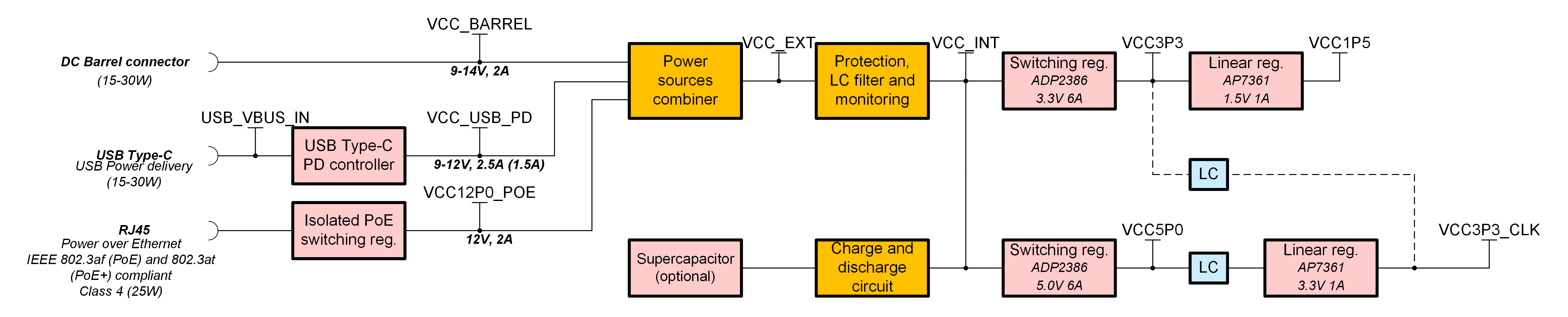

Power Distribution
LimePSB RPCM board power delivery network consists of different power rails with different regulators, voltages and filters. LimePSB RPCM board power distribution block diagram is presented in Figure 10.
Figure 10. LimePSB RPCM v1.1 board power distribution block diagram
LimePSB RPCM board may be supplied from USB Type-C port (USB Power delivery), Ethernet RJ45 port (PoE) or barrel DC connector (9-14V):
USB Type-C socket (9-12V 2.5 A or 1.5 A) may be used to supply LimePSB RPCM board. In this case make sure that USB Power Delivery 18W or more power adapter is used. Depending on application board requested current from source may be lowered from 2.5A to 1.5A by placing jumper on header J48.
RJ45 socket is an alternative way to supply the LimePSB RPCM board. Make sure PoE+ (802.3at) class 4 compliant power source is used.
