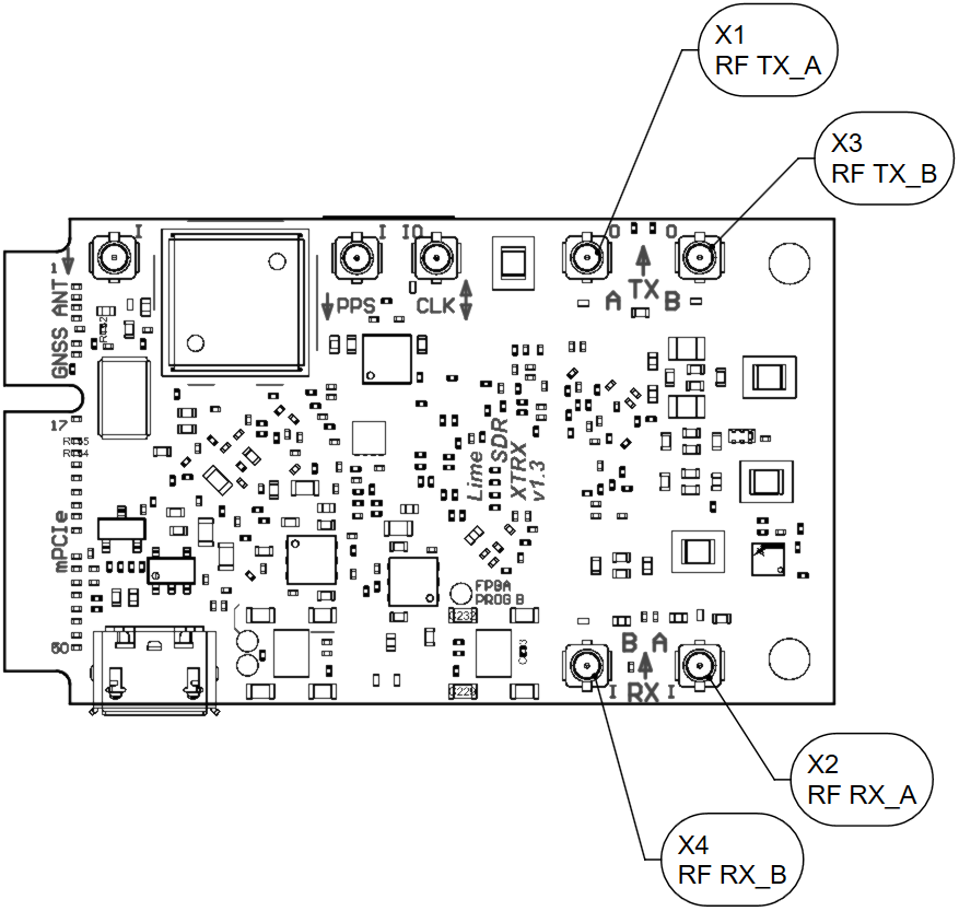

RF Connections
Figure 3: LimeSDR XTRX v1.3 board top with RF connector positions
Connector |
Type |
Function |
Band |
Frequency range |
X1 (Ch1), X3 (Ch2) |
U.FL |
TX ouptut |
TX low |
0.03 - 1.9 GHz |
TX high |
3.3 - 3.8 GHz |
X2 (Ch1), X4 (Ch2) |
U.FL |
RX input |
RX low |
0.3 - 2.2 GHz |
RX wide |
0.7 - 2.6 GHz |
RX high |
3.3 - 3.8 GHz |
Note
TX and RX bands frequency ranges are determined by matching networks. These bands frequency ranges can be changed by replacing their matching networks components.
