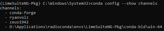

To double check if the channel was added use the following command:
conda config --show channels
Conda should print a similar channel list as shown in Figure 1.
