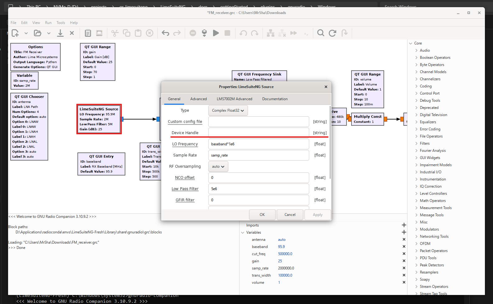

If a single LimeSDR device is pluged in, run the example by pressing the play button. The software will automatically detect the LimeSDR device and use it to run the example. If multiple LimeSDR devices are present, you must enter serial number of appropriate LimeSDR device as shown in figure below.
