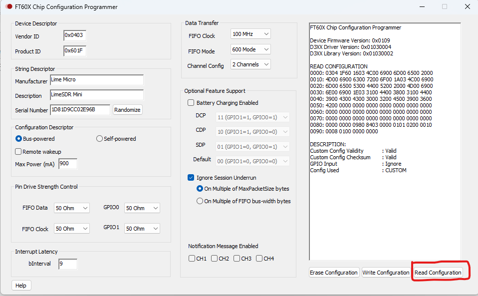

How to configure FT601 USB3.0 chip?
Download FT600ChipConfigurationProgUtility_v1.3.0.2.zip , connect board and hit “Read Configuration” (make sure that any other software is closed and is not using the board). You should see following settings:

Check FT601 chip configuration, see How to configure FT601 USB3.0 chip? .
