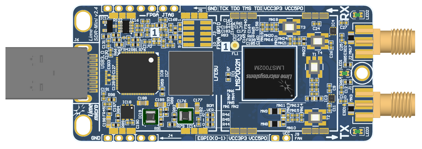

Figure 1: LimeSDR Mini v2.4 board top view

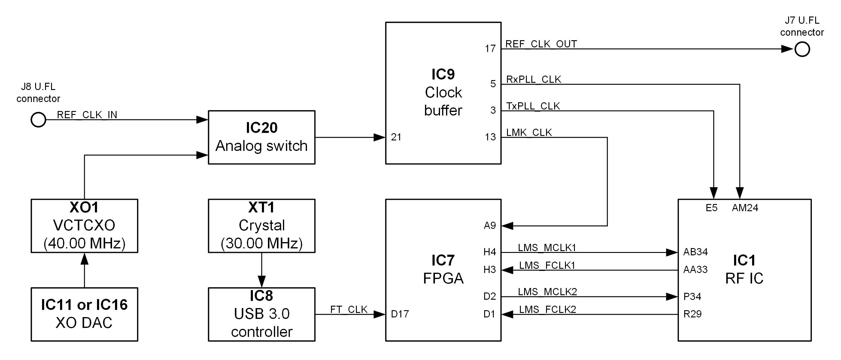

Clock system:
40.00MHz on board VCTCXO
VCTCXO can be tuned by onboard DAC
Reference clock input and output connectors (U.FL)
Analog switch for clock source selection

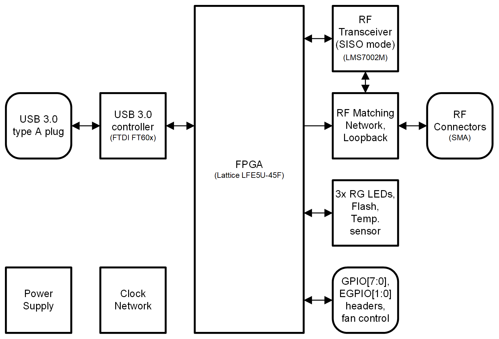

The heart of the LimeSDR-Mini board is Lattice ECP5 (LFE5U-45F) FPGA. It’s main function is to transfer digital data between the PC through a USB 3.0 connector. The block diagram for LimeSDR-Mini board is presented in the Figure 3.
Figure 3: LimeSDR Mini v2.4 Development Board Block Diagram
This section contains component location description on the board. LimeSDR-Mini board picture with highlighted connectors and main components is presented in Figure 4 and Figure 5.
Figure 4: LimeSDR Mini v2.4 board top connectors and main components

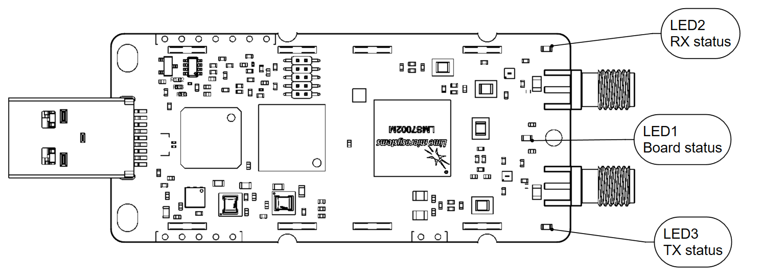

LED1, LED2, LED3 |
Red-green status LEDs |
User defined FPGA indication LED. |

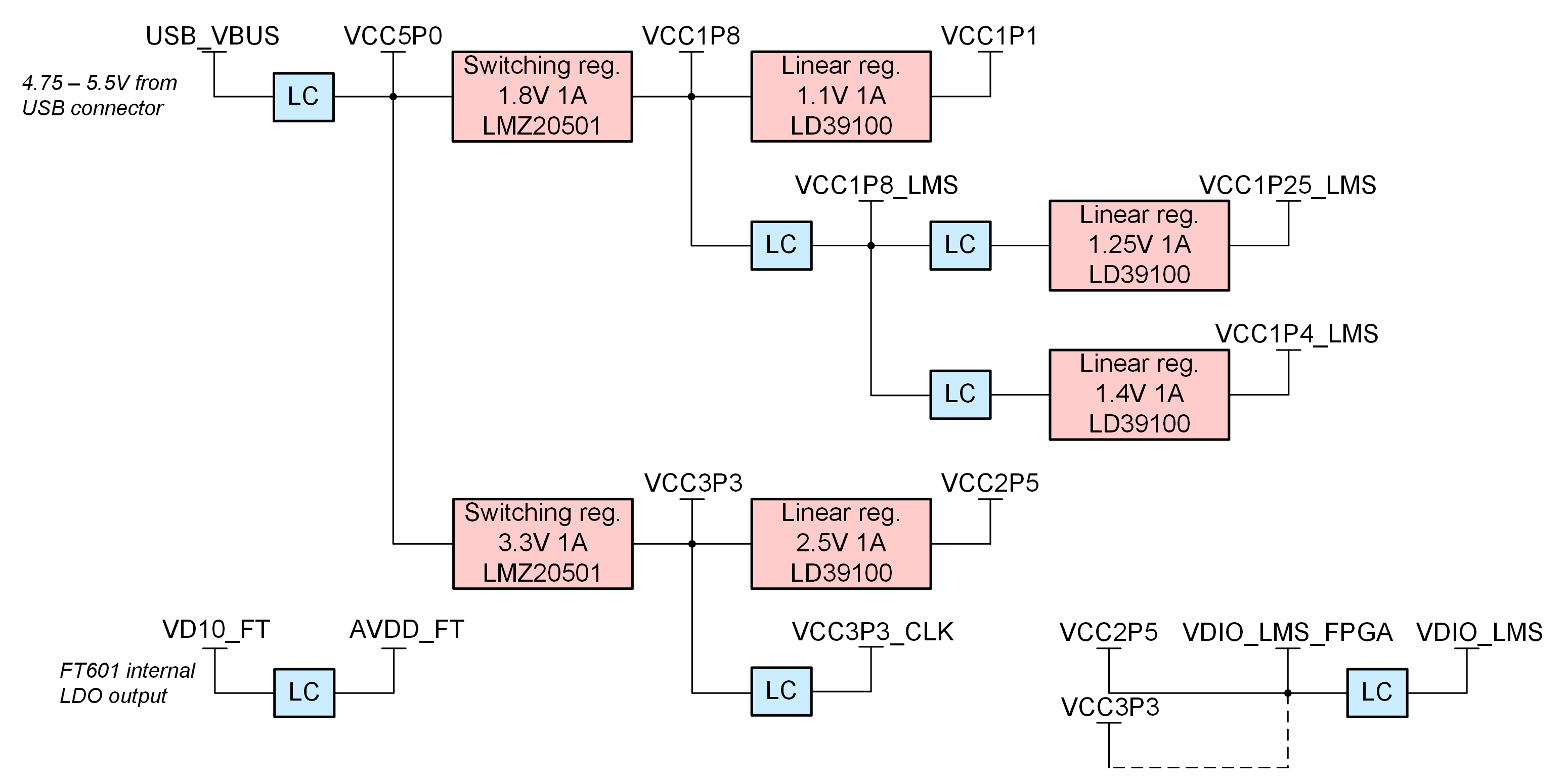

Power Supply |
IC14 |
IC |
Switching regulator LMZ20501 (1.8V rail) |
IC19 |
IC |
Switching regulator LMZ20501 (3.3V rail) |
IC13 |
IC |
Linear regulator LD39100PUR (1.1V rail) |
IC5 |
IC |
Linear regulator LD39100PUR (1.25V rail) |
IC6 |
IC |
Linear regulator LD39100PUR (1.4V rail) |
IC18 |
IC |
Linear regulator LD39100PUR (2.5V rail) |

Indication LEDs
LimeSDR Mini board comes with three dual colour (red and green (RG)) indication LEDs. These LEDs are soldered on the top of the board near RF connectors.
Figure 7: LimeSDR Mini v2.4 indication LEDs (top and bottom)
LEDs are connected to FPGA and their function may be programmed according to the user requirements. Default function of LEDs and related information is listed in Table 6.
Board reference |
Schematic name |
Board label |
FPGA pin |
Comment |
LED1 |
FPGA_LED1_R |
LED1 |
V17 |
Board status: Blinking green = LMK_CLK clock is running; Red = USB control port is active. |
FPGA_LED1_G |
R16 |
LED2 |
FPGA_LED2_R |
LED2 |
R18 (FPGA_GPIO5) |
RX status: Green = DIQ data receive enabled; Off = DIQ data receive disabled. Shared with FPGA_GPIO4 and FPGA_GPIO5. |
FPGA_LED2_G |
M18 (FPGA_GPIO4) |
LED3 |
FPGA_LED3_R |
LED3 |
R17 (FPGA_GPIO7) |
TX status: Red = transmitting DIQ data; Off = no activity. Shared with FPGA_GPIO6 and FPGA_GPIO7. |
FPGA_LED3_G |
T17 (FPGA_GPIO6) |

JTAG interface
To debug FPGA design, flash bitstream to FPGA and/or Flash memory JTAG is used. It is located on the PCB top side (see Figure 4: LimeSDR Mini v2.4 board top connectors and main components) and attaches to the programmer using 7-pin, 0.1” spaced JTAG connector J5. JTAG connector pins, schematic signal names, FPGA interconnections and I/O standards are listed in Table 12.
Connector pin |
Schematic signal name |
FPGA pin |
I/O standard |
Comment |
1 |
GND |
Ground |
2 |
TCK |
U13 |
3.3V |
Test Clock |
3 |
TDO |
V14 |
3.3V |
Test Data Out |
4 |
TMS |
V13 |
3.3V |
Test Mode Select |
5 |
TDI |
T13 |
3.3V |
Test Data In |
6 |
VCC3P3 |
Power (3.3V) |
7 |
VCC5P0 |
Power (5.0V) |
More information about JTAG programming can be found in JTAG Programming.

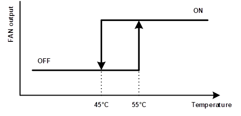

LimeSDR-Mini has integrated temperature sensor which controls FAN to keep board in operating temperature range. FAN must be connected to J9 (0.1” pitch) connector. FAN control voltage y default is 5V, but it can be changed to 3.3V by resistors.
Fan will be turned on if board will heat up to 55°C and FAN will be turned off if board will cool down to 45°C.
Figure 8: FAN control temperature hysteresis
Clock distribution
LimeSDR-Mini board clock distribution block diagram is presented in Figure 9. LimeSDR-Mini board has onboard 40.00 MHz VCTCXO that is reference clock for RF transceiver and FPGA PLLs. Board clock distribution block diagram is presented in Figure 9.
Figure 9: LimeSDR Mini v2.4 board clock distribution block diagram
Rakon E7355LF 40 MHz voltage controlled temperature compensated crystal oscillator (VCTCXO) is main board clock source. VCTCXO frequency can be tuned by using DAC (IC11 10 bit or IC16 16 bit (unpopulated)). Main VCTCXO parameters are listed in Table 13.
Frequency parameter |
Value |
Calibration (25°C ± 1°C) |
± 1 ppm max |
Stability (-40 to 85 °C) |
± 0.5 max |
Long term stability (1 year, 10 years) |
± 2 ppm max, ± 4 ppm max |
Control voltage range |
0.5V .. 2.5V |
Frequency tuning |
± 7 ppm min, ± 15 ppm max |
Slope |
+9 ppm/V |
VCTCXO clock and external reference clock connector J8 (REF_CLK_IN) are connected to analog switch for clock source selection. Selected clock source is fed to clock buffer IC9. Buffered clock is connected to RF transceiver and FPGA. Buffered clock is also connected to connector J7 (REF_CLK_OUT) and can be fed to external hardware for synchronisation.
Main board clock lines and other related information are listed in Table 14
Source |
I/O standard |
FPGA pin |
Description |
External |
REF_CLK_IN |
2.5V/3.3V |
External reference clock input |
Clock buffer (IC9) |
REF_CLK_OUT |
3.3V |
Reference clock output |
LMK_CLK |
3.3V |
A9 |
Reference clock connected to FPGA |
RF transceiver (IC1) |
RxPLL_CLK |
1.8V |
Reference clock input |
TxPLL_CLK |
1.8V |
LMS_MCLK1 |
2.5V/3.3V |
H4 |
LMS_FCLK1 |
2.5V/3.3V |
H3 |
LMS_MCLK2 |
2.5V/3.3V |
D2 |
LMS_FCLK2 |
2.5V/3.3V |
D1 |
USB 3.0 controller (IC8) |
FT_CLK |
3.3V |
D17 |
Clock output (100 MHz) from USB controller |
Power distribution
LimeSDR-Mini board is powered from USB port (5V). LimeSDR-Mini board power delivery network consists of different power rails with different voltages, filters, power sequences. LimeSDR-Mini board power distribution block diagram is presented in Figure 10.
Figure 12: LimeSDR Mini v2.4 board power distribution block diagram
