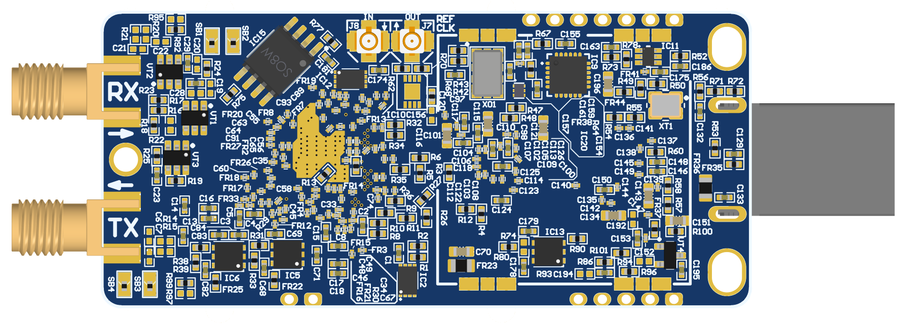

Figure 1: LimeSDR Mini v2.3 board top view

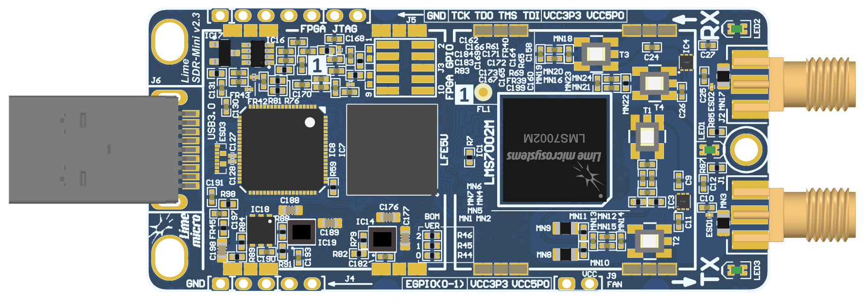

Figure 2: LimeSDR Mini v2.3 board bottom view

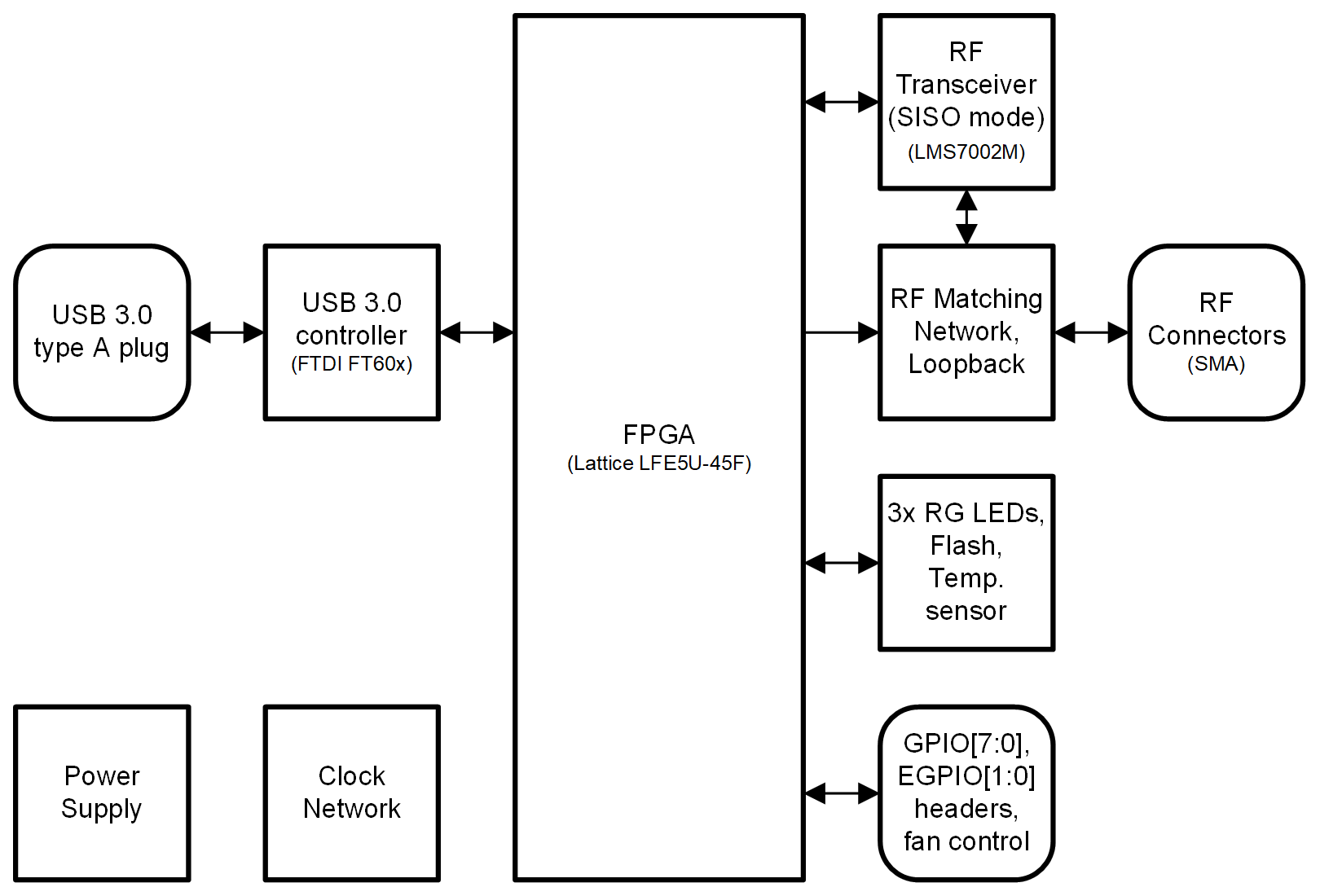

The heart of the LimeSDR-Mini board is Lattice ECP5 (LFE5U-45F) FPGA. It’s main function is to transfer digital data between the PC through a USB 3.0 connector. The block diagram for LimeSDR-Mini board is presented in the Figure
Figure 3: LimeSDR Mini v2.3 Development Board Block Diagram

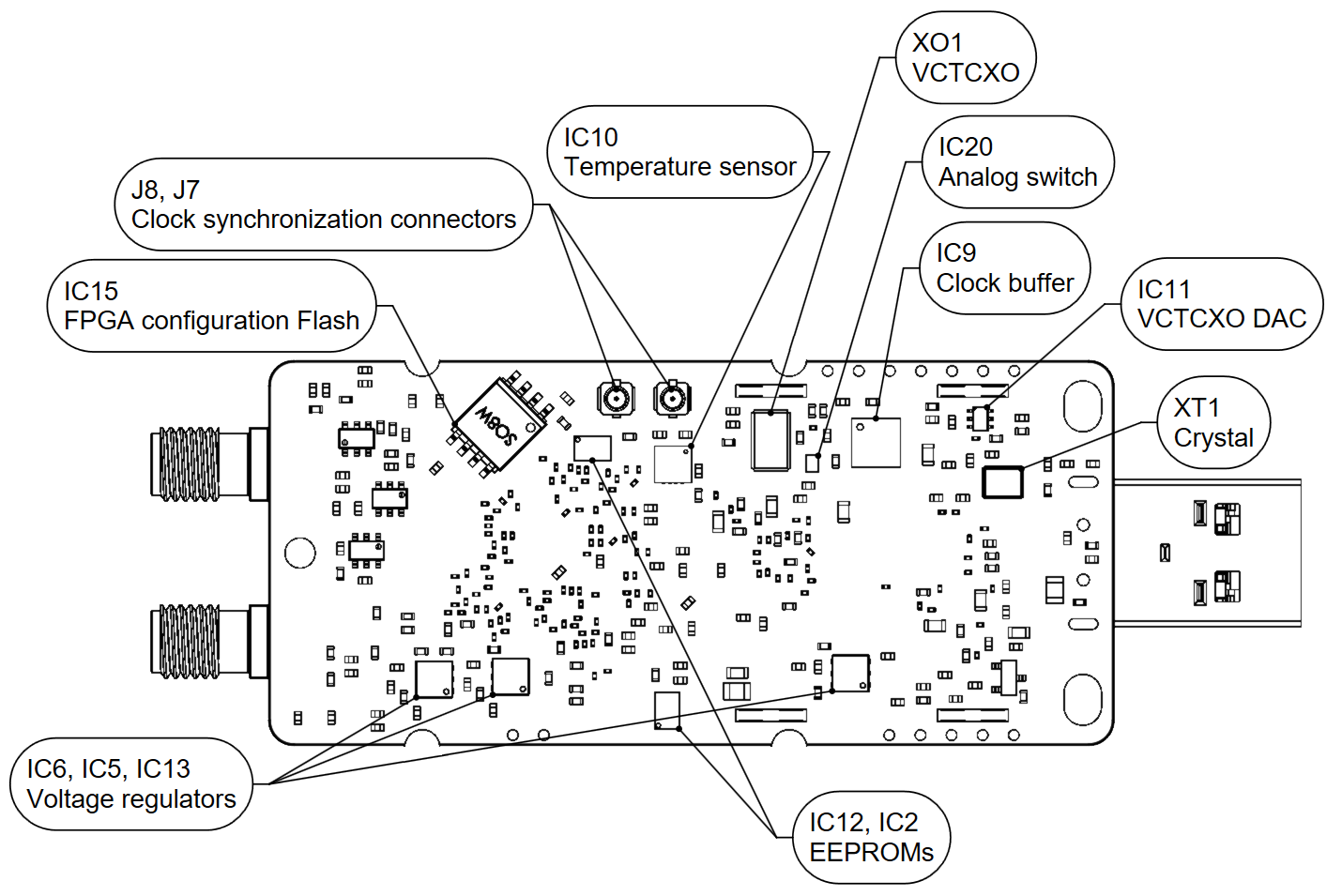

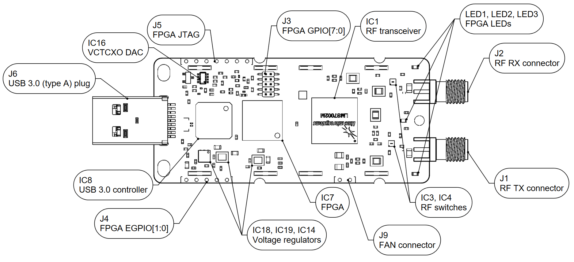

This section contains component location description on the board. LimeSDR-Mini board picture with highlighted connectors and main components is presented in Figure 4 and Figure 5.
Figure 4: LimeSDR Mini v2.3 board top connectors and main components
Figure 5: LimeSDR Mini v2.3 board bottom connectors and main components
Description of board components is given in the Table 1.

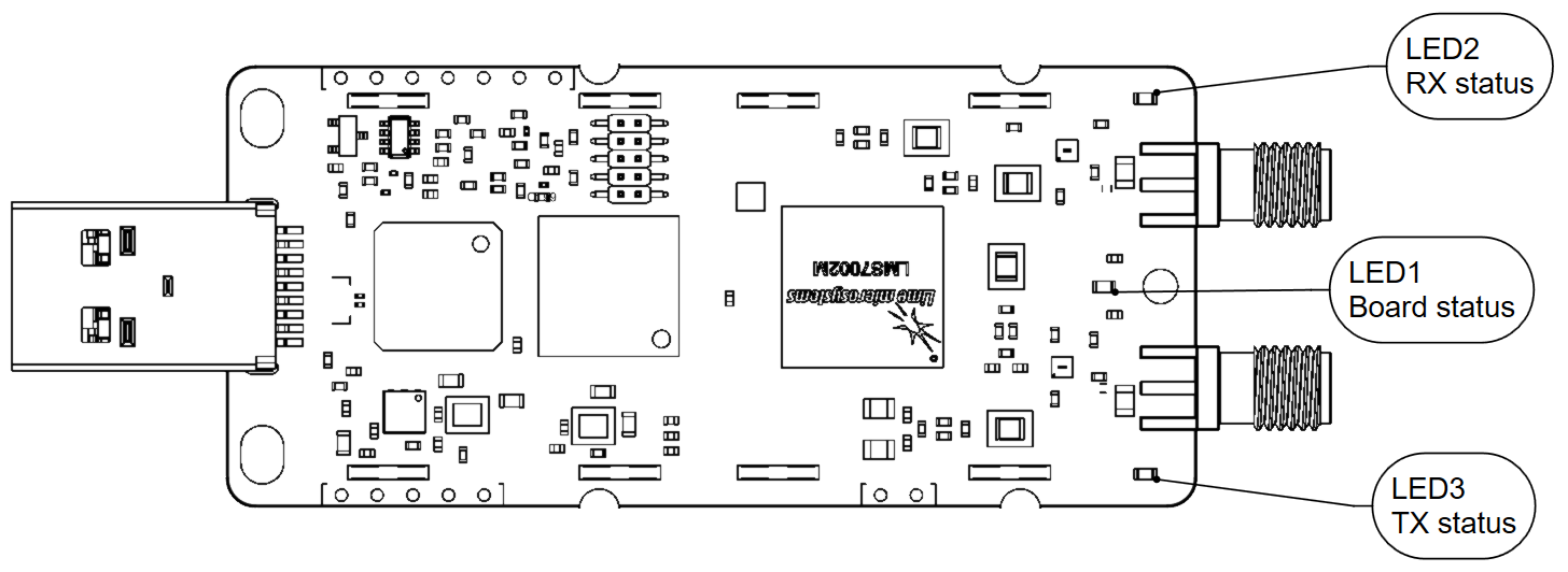

LED1, LED2, LED3 |
Red-green status LEDs |
User defined FPGA indication LED. |

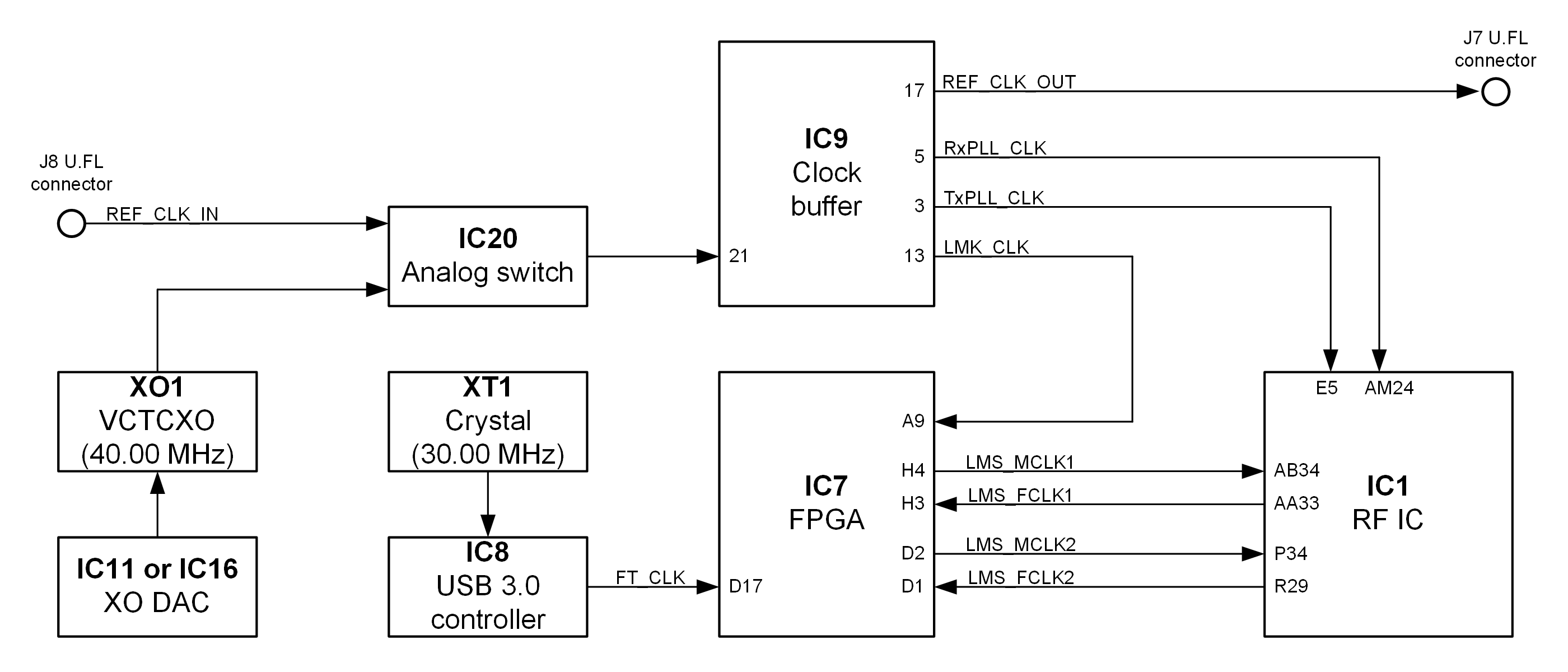

Clock Circuitry |
XO1 |
VCTCXO |
40.00 MHz Voltage Controlled Temperature Compensated Crystal Oscillator |
IC11 |
IC |
10 bit DAC for TCXO (XT4) frequency tuning (default) |
IC16 |
IC |
16 bit DAC for TCXO (XT4) frequency tuning (unpopulated) |
IC17 |
IC |
Voltage reference (unpopulated) |
IC9 |
IC |
Clock buffer |
IC20 |
IC |
Analog switch |
J8 |
U.FL connector |
Reference clock input |
J7 |
U.FL connector |
Reference clock output |

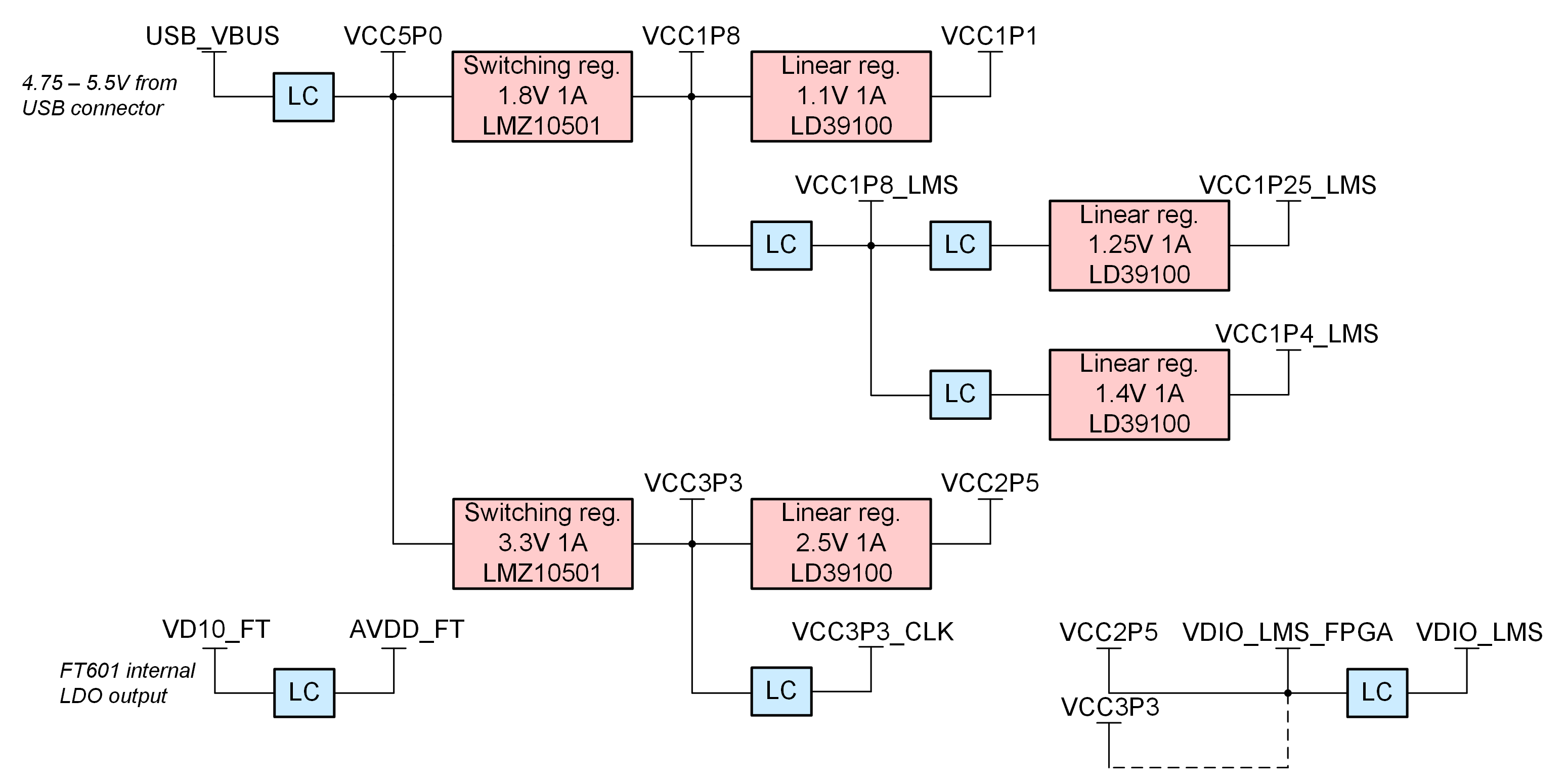

Power Supply |
IC14 |
IC |
Switching regulator LMZ10501 (1.8V rail) |
IC19 |
IC |
Switching regulator LMZ10501 (3.3V rail) |
IC13 |
IC |
Linear regulator LD39100PUR (1.1V rail) |
IC5 |
IC |
Linear regulator LD39100PUR (1.25V rail) |
IC6 |
IC |
Linear regulator LD39100PUR (1.4V rail) |
IC18 |
IC |
Linear regulator LD39100PUR (2.5V rail) |

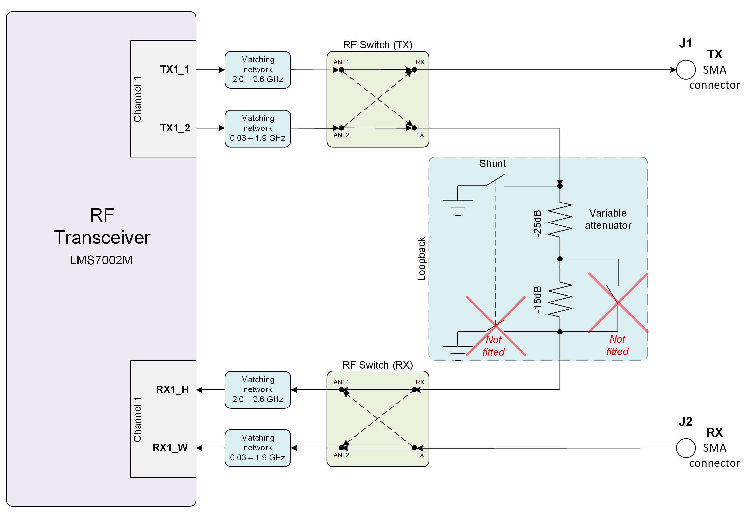

RF path and control signals
LimeSDR-Mini RF path contains matching networks, RF switches, loopback variable attenuator and 2 SMA connectors (J1 - TX and J2 - RX) as shown in Figure 6.
Figure 6: LimeSDR Mini v2.3 RF diagram
RF transceiver TX and RX ports has its dedicated matching network which together determines the working frequency range. More detailed information about RF transceiver ports and matching network frequency ranges is listed in the Table 3.
RF transceiver port |
Frequency range |
TX1_1 |
2 GHz - 2.6 GHz |
TX1_2 |
30 MHz - 1.9 GHz |
RX1_H |
2 GHz - 2.6 GHz |
RX1_W |
700 MHz - 900 MHz |
RF path control signals are described in the Table 4.
Component |
Schematic signal name |
I/O standard |
FPGA pin |
Description |
RFSW_TX (SKY13411-374LF – IC3) |
RFSW_TX_V1 |
3.3V |
B10 |
V1 – high V2- low TX1_1 to TX and TX1_2 to ATT, V1 – low V2 – high TX1_1 to ATT and TX1_2 to TX |
RFSW_TX_V2 |
3.3V |
C9 |
RFSW_RX (SKY13411-374LF – IC3) |
RFSW_RX_V1 |
3.3V |
C11 |
V1 – high V2- low RX_H to RX and RX1_W to ATT, V1 – low V2 – high RX1_H to ATT and RX1_W to RX |
RFSW_RX_V2 |
3.3V |
B11 |
Variable attenuator |
TX_LB_AT |
3.3V |
C8 |
High - -40dB, low - -25dB |
TX_LB_SH |
3.3V |
B8 |
Attenuator shunting. |

Indication LEDs
LimeSDR Mini board comes with three dual colour (red and green (RG)) indication LEDs. These LEDs are soldered on the top of the board near RF connectors.
Figure 7: LimeSDR Mini v2.3 indication LEDs (top and bottom)
LEDs are connected to FPGA and their function may be programmed according to the user requirements. Default function of LEDs and related information is listed in Table 6.

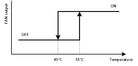

Board temperature control
LimeSDR-Mini has integrated temperature sensor which controls FAN to keep board in operating temperature range. FAN must be connected to J9 (0.1” pitch) connector. FAN control voltage y default is 5V, but it can be changed to 3.3V by resistors.
Fan will be turned on if board will heat up to 55°C and FAN will be turned off if board will cool down to 45°C.
Figure 8: FAN control temperature hysteresis
Clock distribution
LimeSDR-Mini board clock distribution block diagram is presented in Figure 9. LimeSDR-Mini board has onboard 40.00 MHz VCTCXO that is reference clock for RF transceiver and FPGA PLLs. Board clock distribution block diagram is presented in Figure 9.
Figure 9: LimeSDR Mini v2.3 board clock distribution block diagram
Rakon E7355LF 40 MHz voltage controlled temperature compensated crystal oscillator (VCTCXO) is main board clock source. VCTCXO frequency can be tuned by using DAC (IC11 10 bit or IC16 16 bit (unpopulated)). Main VCTCXO parameters are listed in Table 13.

VCTCXO clock and external reference clock connector J8 (REF_CLK_IN) are connected to analog switch for clock source selection. Selected clock source is fed to clock buffer IC9. Buffered clock is connected to RF transceiver and FPGA. Buffered clock is also connected to connector J7 (REF_CLK_OUT) and can be fed to external hardware for synchronisation.
Main board clock lines and other related information are listed in Table 14.
Source |
I/O standard |
FPGA pin |
Description |
External |
REF_CLK_IN |
2.5V/3.3V |
External reference clock input |
Clock buffer (IC9) |
REF_CLK_OUT |
3.3V |
LMK_CLK |
3.3V |
A9 |
Reference clock connected to FPGA |
RF transceiver (IC1) |
RxPLL_CLK |
1.8V |
TxPLL_CLK |
1.8V |
LMS_MCLK1 |
2.5V/3.3V |
H4 |
LMS_FCLK1 |
2.5V/3.3V |
H3 |
LMS_MCLK2 |
2.5V/3.3V |
D2 |
LMS_FCLK2 |
2.5V/3.3V |
D1 |
USB 3.0 controller (IC8) |
FT_CLK |
3.3V |
D17 |
Clock output (100 MHz) from USB controller |
Power distribution
LimeSDR-Mini board is powered from USB port (5V). LimeSDR-Mini board power delivery network consists of different power rails with different voltages, filters, power sequences. LimeSDR-Mini board power distribution block diagram is presented in Figure 10.
Figure 12: LimeSDR Mini v2.3 board power distribution block diagram
