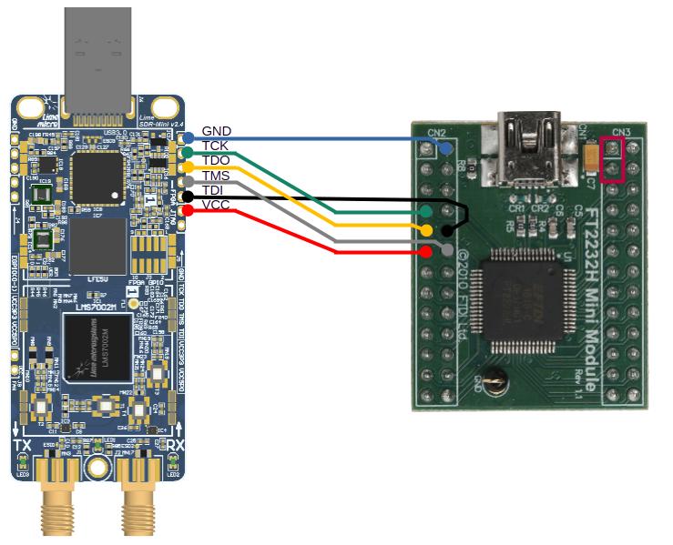

Connect LimeSDR Mini v2 to FT2232H Mini module as specified in Table 2 (see Figure 1 for graphical representation).

Figure 1: LimeSDR Mini v2 board and FT2232H Mini module connections

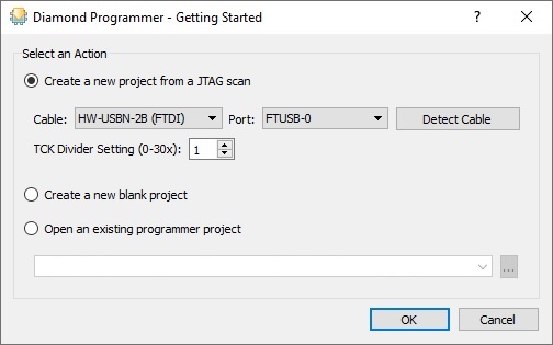

Connect LimesdSDR Mini v2 board to FTDI FT2232H Mini Module as described in paragraph above and connect them to PC via USB ports. Launch software “Lattice Diamond Programmer”. Cable HW-USBN-2B (FTDI) and port FTUSB-0 must be selected, as shown in Figure 2.
Figure 2: Cable and port selection

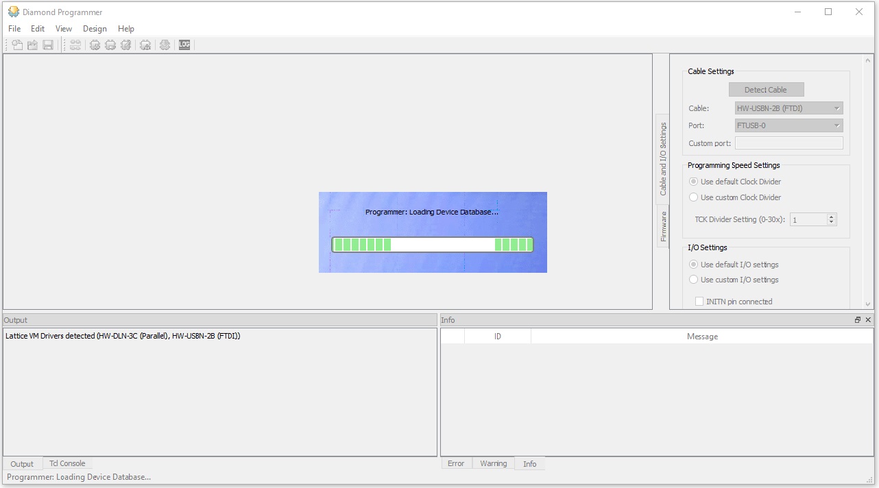

Select an action “Create a new project from JTAG scan” and press “OK” button. Device database loading and JTAG scanning procedures will start, as shown in Figure 3.
Figure 3: Device database loading and JTAG scanning procedure

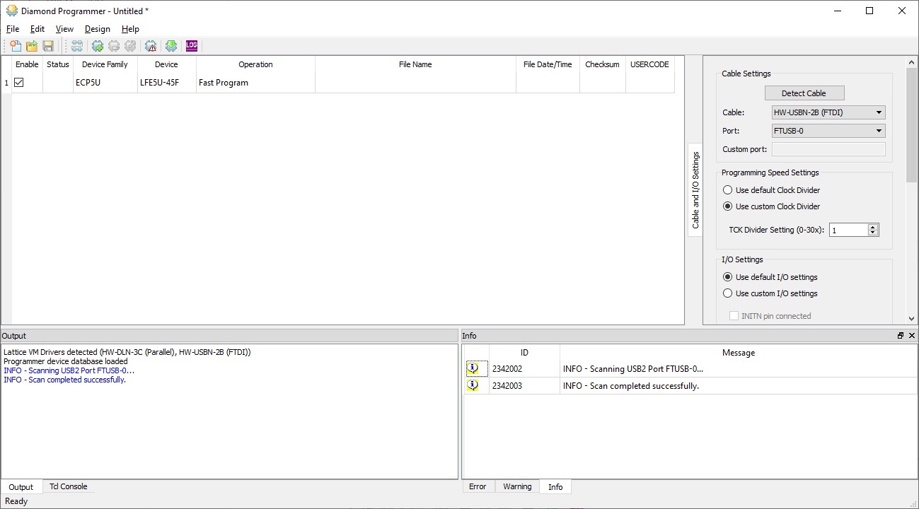

After successful JTAG chain scan ECP5U family FPGA device will be detected (in this case LFE5U-45F), as shown in Figure 4.
Figure 4: Detected FPGA device

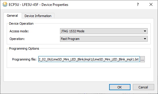

In context menu press “Edit -> Device properties” and set device operation parameters as shown in Figure 5. Also load appropriate programming file (gateware, bitstream) and then press “OK”.
Figure 5: Device operation parameters and programming file

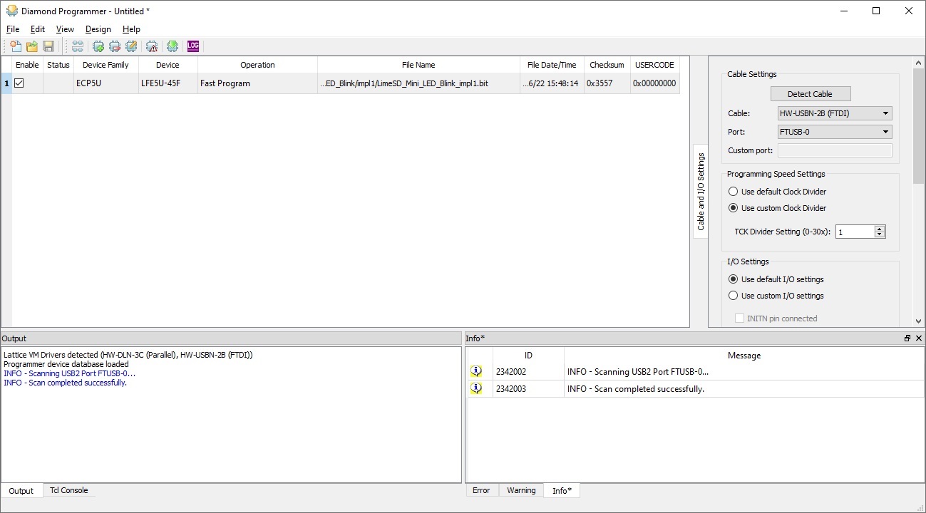

The main program window should look as shown in Figure 6.
Figure 6: Main program window

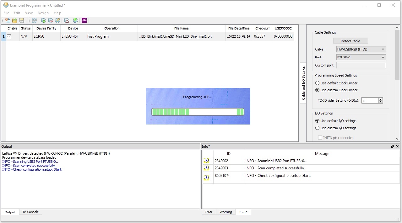

In context menu press “Design -> Program” and RAM programming procedure will start, as shown in Figure 7.
Figure 7: Programming procedure

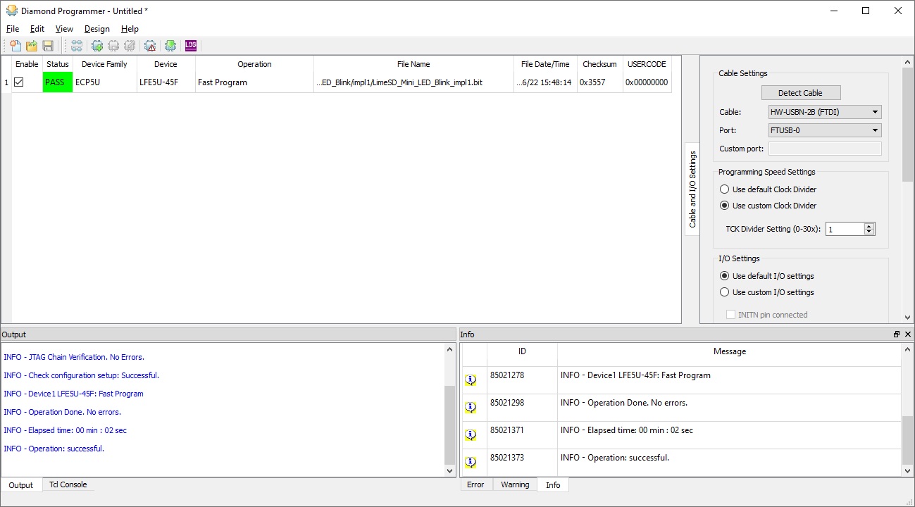

After successful programming operation “Status” field will change to “PASS” highlihted in green as shown in Figure 8 and FPGA will start execution of a new gateware.
Figure 8: Successful programming result

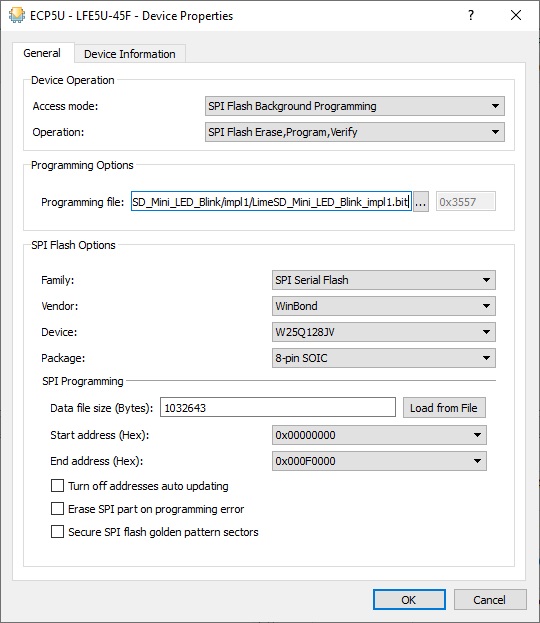

In context menu press “Edit -> Device properties” and in section “Device Operation” set “Access mode” to “SPI Flash Background Programming” and “Operation” to “SPI Flash Erase,Program,Verify”.
Load appropriate programming file (gateware, bitstream) and set the remaining parameters for Winbond W25Q128JV flash memory as shown in the image below and then press “OK”.
Figure 8: LimeSDR Mini v2 board and FT2232H Mini module connections

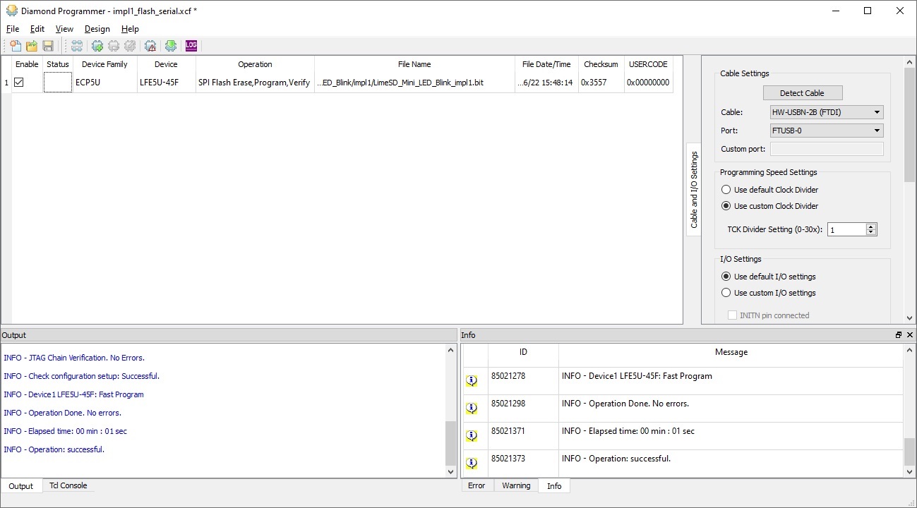

The main program window should look like shown in figure 9.
Figure 9: Main program window

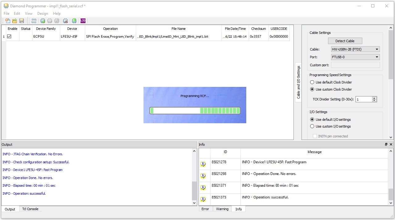

In context menu press “Design -> Program” and Flash programming procedure will start, as shown in Figure 10.
Figure 10: Flash in progress

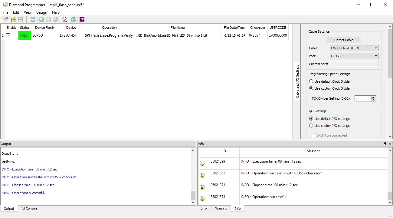

After successful programming operation “Status” field will change to “PASS” highlihted in green as shown in Figure 11 and FPGA will start execution of a new gateware.
Figure 11: Successful programming
