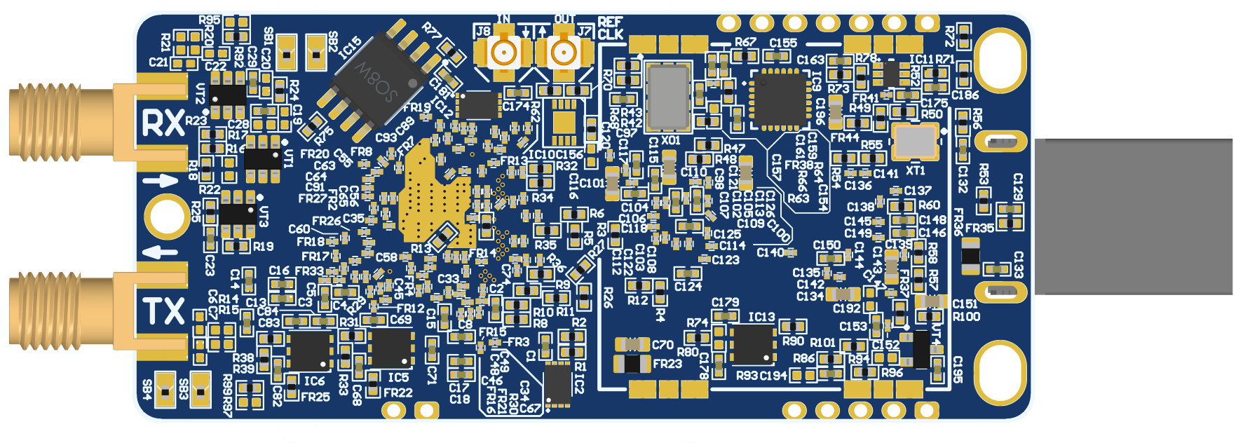

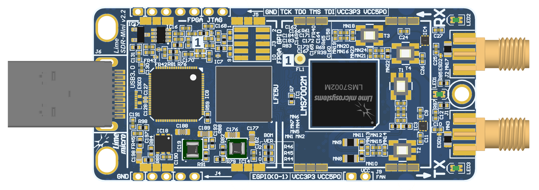

Figure 1: LimeSDR Mini v2.2 board top view
Figure 2: LimeSDR Mini v2.2 board bottom view

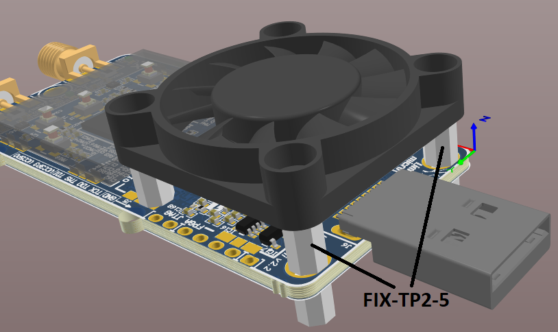

FAN (5V default or 3.3V) connector

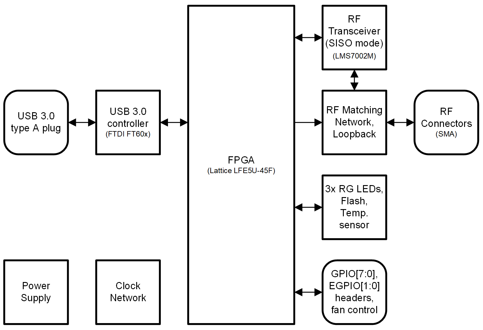

The heart of the LimeSDR Mini board is Lattice ECP5 (LFE5U-45F) FPGA. It’s main function is to transfer digital data between the PC through a USB 3.0 connector. The block diagram for LimeSDR Mini board is presented in the Figure 3.
Figure 3: LimeSDR Mini v2.2 Development Board Block Diagram

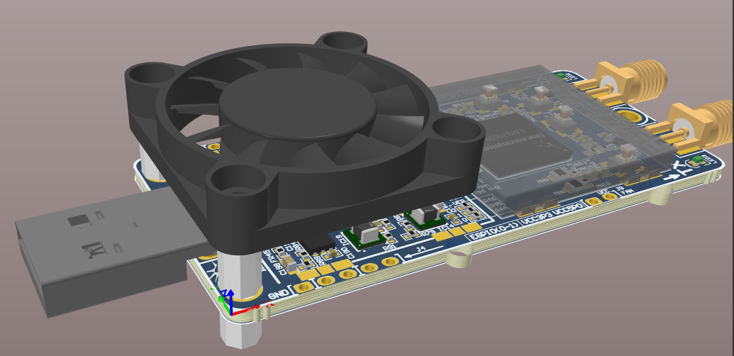

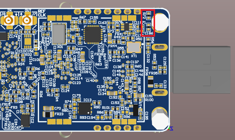

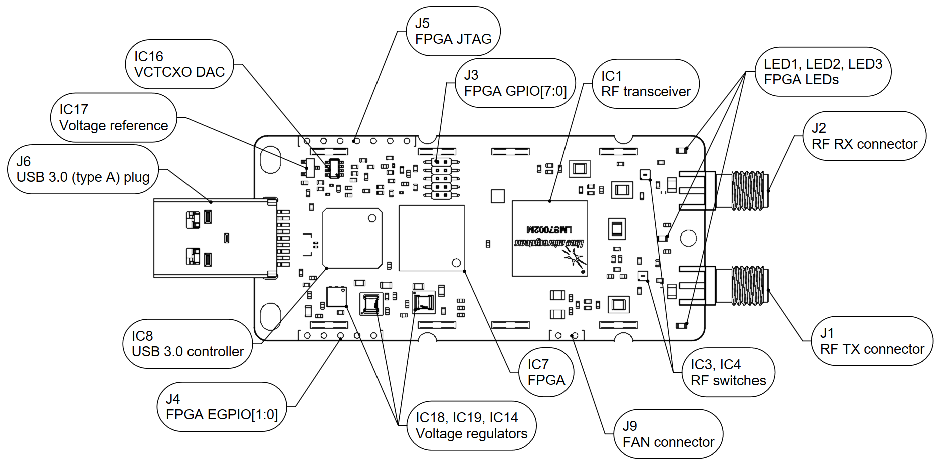

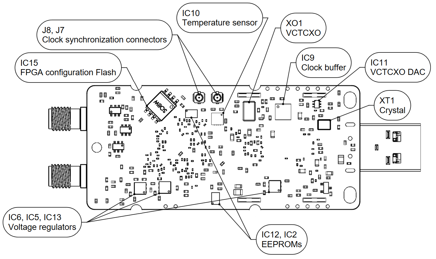

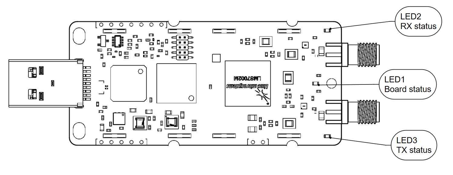

This section contains component location description on the board. LimeSDR Mini board picture with highlighted connectors and main components are presented in Figure 4 and Figure 5.
Figure 4: LimeSDR Mini v2.2 board top connectors and main components
Figure 5: LimeSDR Mini v2.2 board bottom connectors and main components
Description of board components is given in the Table 1.
Featured Devices |
Board Reference |
Type |
Description |
IC1 |
RF transceiver |
Lime Microsystems LMS7002M |
IC7 |
FPGA |
Lattice Semiconductor’s LFE5U (LFE5U-45F) |
IC8 |
USB 3.0 microcontroller |
FTDI USB 3.0 to FIFO interface bridge chip FT601 |
Miscellaneous devices |
IC10 |
IC |
Temperature sensor LM75 |
Configuration, Status and Setup Elements |
J5 |
JTAG chain connector |
FPGA programming pin header on the board edge for JTAG cable, 0.1” pitch |
LED1, LED2, LED3 |
Red-green status LEDs |
User defined FPGA indication LED. |
General User Input/Output |
J3 |
Pin header |
8x FPGA GPIOs, 3.3V, 0.05” pitch |
J4 |
Pin header |
2x FPGA GPIOs on the board edge, 3.3V, 0.1” pitch |
J9 |
Pin header |
5V (3.3V voltage can be chosen by resistors) fan connection pin headers, 0.1” pitch |
Memory Devices |
IC2 |
IC |
I²C EEPROM Memory 128Kb (16 x 8), connected to RF transceiver I2C bus |
IC12 |
IC |
I²C EEPROM Memory 128Kb (16K x 8), connected to FPGA I2C bus |
IC15 |
IC |
Quad SPI Flash Memory 128 Mb (16M x 8) connected to FPGA SPI |
Communication Ports |
J6 |
USB 3.0 connector |
USB 3.0 (type A) plug |

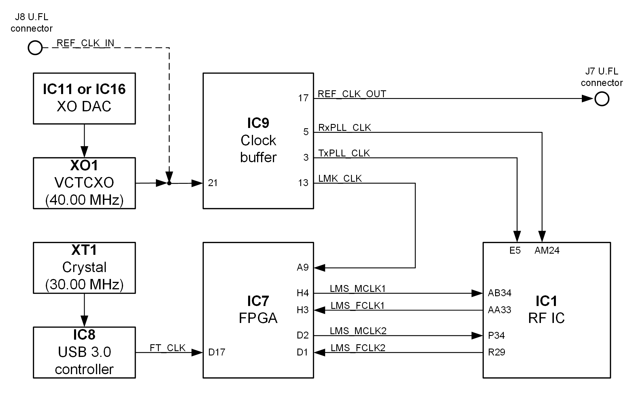

Clock Circuitry |
XO1 |
VCTCXO |
40.00 MHz Voltage Controlled Temperature Compensated Crystal Oscillator |
IC11 |
IC |
10 bit DAC for TCXO (XT4) frequency tuning (default) |
IC16 |
IC |
16 bit DAC for TCXO (XT4) frequency tuning (unpopulated) |
IC17 |
IC |
Voltage reference (unpopulated) |
IC9 |
IC |
Clock buffer |
J8 |
U.FL connector |
Reference clock input |
J7 |
U.FL connector |
Reference clock output |

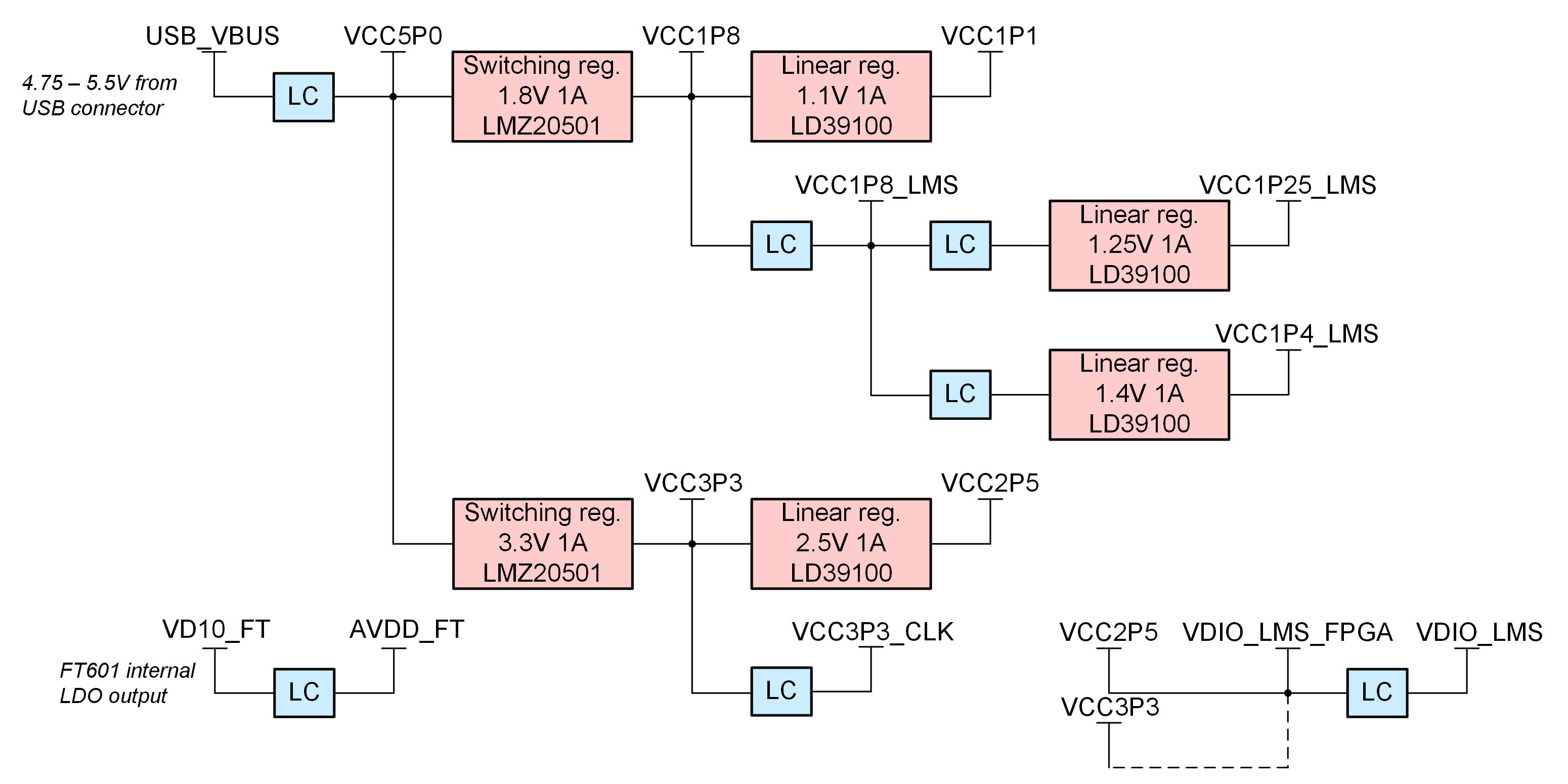

Power Supply |
IC14 |
IC |
Switching regulator LMZ20501 (1.8V rail) |
IC19 |
IC |
Switching regulator LMZ20501 (3.3V rail) |
IC13 |
IC |
Linear regulator LD39100PUR (1.1V rail) |
IC5 |
IC |
Linear regulator LD39100PUR (1.25V rail) |
IC6 |
IC |
Linear regulator LD39100PUR (1.4V rail) |
IC18 |
IC |
Linear regulator LD39100PUR (2.5V rail) |

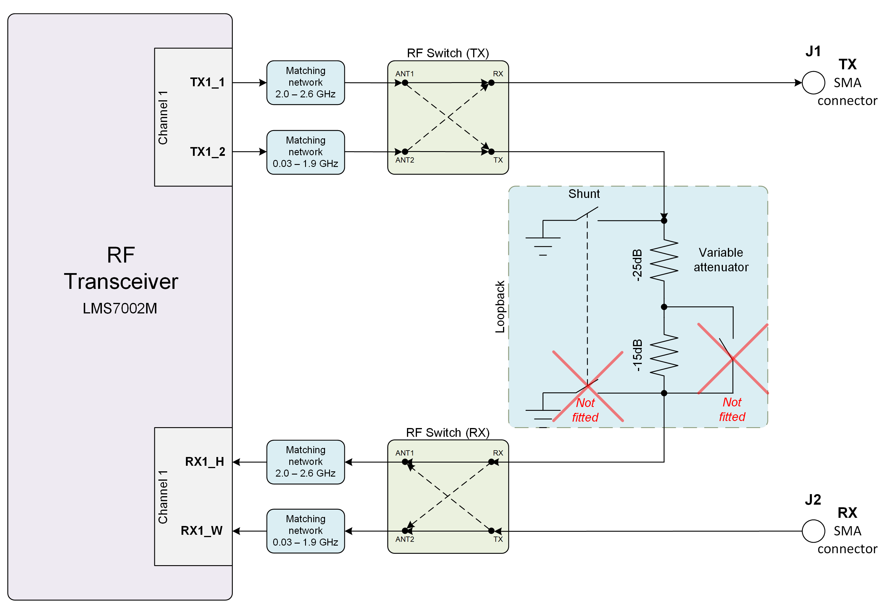

RF path and control signals
LimeSDR Mini RF path contains matching networks, RF switches, loopback variable attenuator and 2 SMA connectors (J1 - TX and J2 - RX) as shown in Figure 6.
Figure 6: LimeSDR Mini v2.2 RF diagram
RF transceiver TX and RX ports has its dedicated matching network which together determines the working frequency range. More detailed information about RF transceiver ports and matching network frequency ranges is listed in the Table 3.
RF transceiver port |
Frequency range |
TX1_1 |
2 GHz - 2.6 GHz |
TX1_2 |
30 MHz - 1.9 GHz |
RX1_H |
2 GHz - 2.6 GHz |
RX1_W |
700 MHz - 900 MHz |
RF path control signals are described in the Table 4.

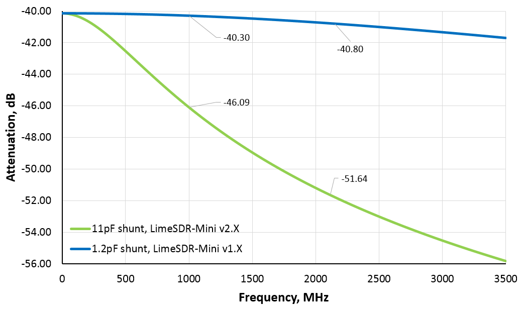

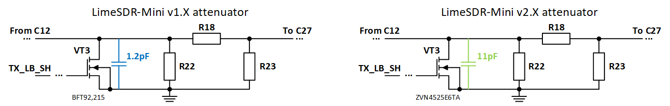

Notes on RF loopback
LimeSDR Mini v2.X encountered a change of shunt transistor VT3 in the RF feedback attenuator chain due to the original part becoming EOL. The original part BFT92,215 had a small output capacitance of around 1.2 pF, whereas the new RF transistor ZVN4525E6TA has a larger output capacitance of 11 pF. An extract of the schematic is presented in Figure 7.
Figure 7: LimeSDR Mini RF loopback attenuator implementation on v1.x and v2.x boards
The increased shunt capacitance affects a frequency response of the attenuator as shown in Figure 3. The attenuation is −46 dB at 1 GHz and −52 dB at 2.1 GHz for the new LimeSDR-Mini v2.X board. The frequency response shown in Figure 8 can be used as a reference RF loopback attenuation in the supported frequency range.
Figure 8: LimeSDR Mini v2.2 RF loopback frequency response

Indication LEDs
LimeSDR Mini board comes with three dual colour (red and green (RG)) indication LEDs. These LEDs are soldered on the top of the board near RF connectors.
Figure 9: LimeSDR Mini indication LEDs (top and bottom)
LEDs are connected to FPGA and their function may be programmed according to the user requirements. Default function of LEDs and related information is listed in Table 6.
Board reference |
Schematic name |
Board label |
FPGA pin |
Comment |
LED1 |
FPGA_LED1_R |
LED1 |
V17 |
Board status: Blinking green = LMK_CLK clock is running; Red = USB control port is active. |
FPGA_LED1_G |
R16 |
LED2 |
FPGA_LED2_R |
LED2 |
R18 (FPGA_GPIO5) |
RX status: Green = DIQ data receive enabled; Off = DIQ data receive disabled. Shared with FPGA_GPIO4 and FPGA_GPIO5. |
FPGA_LED2_G |
M18 (FPGA_GPIO4) |
LED3 |
FPGA_LED3_R |
LED3 |
R17 (FPGA_GPIO7) |
TX status: Red = transmitting DIQ data; Off = no activity. Shared with FPGA_GPIO6 and FPGA_GPIO7. |
FPGA_LED3_G |
T17 (FPGA_GPIO6) |

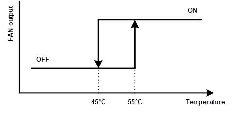

Board temperature control
LimeSDR Mini has integrated temperature sensor which controls FAN to keep board in operating temperature range. FAN must be connected to J9 (0.1” pitch) connector. FAN control voltage y default is 5V, but it can be changed to 3.3V by resistors.
Fan will be turned on if board will heat up to 55°C and FAN will be turned off if board will cool down to 45°C.
Figure 10: FAN control temperature hysteresis
Clock distribution
LimeSDR Mini board clock distribution block diagram is presented in Figure 6. LimeSDR Mini board has onboard 40.00 MHz VCTCXO that is reference clock for RF transceiver and FPGA PLLs.
Figure 11: LimeSDR Mini v2.2 board clock distribution block diagram
Rakon E7355LF 40 MHz voltage controlled temperature compensated crystal oscillator (VCTCXO) is main board clock source. VCTCXO frequency can be tuned by using DAC (IC11 10 bit or IC16 16 bit (unpopulated)). Main VCTCXO parameters are listed in Table 13.
Frequency parameter |
Value |
Calibration (25°C ± 1°C) |
± 1 ppm max |
Stability (-40 to 85 °C) |
± 0.5 max |
Long term stability (1 year, 10 years) |
± 2 ppm max, ± 4 ppm max |
Control voltage range |
0.5V .. 2.5V |
Frequency tuning |
± 7 ppm min, ± 15 ppm max |
Slope |
+9 ppm/V |
VCTCXO clock is connected to clock buffer IC9. Buffered VCTCXO clock is connected to RF transceiver, FPGA. Buffered VCTCXO clock is also connected to connector J7 (REF_CLK_OUT) and can be fed to external hardware for synchronisation. VCTCXO clock can be disconnected from clock buffer input (remove R63 and solder R66) and external reference clock can be supplied from connector J8 (REF_CLK_IN) instead of VCTCXO (40 MHz). Main board clock lines and other related information are listed in Table 14.

Power distribution
LimeSDR Mini board is powered from USB port (5V). LimeSDR Mini board power delivery network consists of different power rails with different voltages, filters, power sequences. LimeSDR Mini board power distribution block diagram is presented in Figure 12.
Figure 12: LimeSDR Mini v2.2 board power distribution block diagram

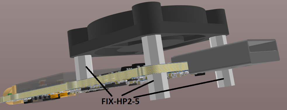

Fan mounting
LimeSDR Mini v2.2 board features three holes which may be used to secure the board into the case or fan mounting for instance as shown in Figure 13. Two holes are placed at the sides of USB connector and one more hole is between SMA connectors.
Figure 13: LimeSDR Mini v2.2 fan mounting
Warning
You have to be careful when using mounting holes not to damage R72 resistor and C186 capacitor while there is no much clearence as you may see in Figure 14.
Figure 14: LimeSDR Mini v2.2 mounting hole clearence
Recommended fan mounting solution is shown in Figure 15.
Figure 15: FIX-TP2-5 fan mounting components
Figure 16: FIX-HP2-5 fan mounting components
Use two FIX-TP2-5 stands with internal and external thread (4mm width, M2 thread) as a spacers to mount the fan on top of LimeSDR Mini v2.2. Put FIX-TP2-5 stands from the top through LimeSDR Mini v2.2 slot mounting holes around USB connector as shown in Figure 11. Secure the stands to the fan using two M2 thread screws (ex. P/N 1219480, Phillips head screw, M2x10). Secure two FIX-TP2-5 stands using two FIX-HP2-5 spacers as nuts from the bottom of the PCB as shown in Figure 12. This is enough to hold the fan but one may use additional FIX-HP2-5 (4mm width, M2 thread) stand with internal thread as an additional fan rest point which rests on PCB over unmounted J3 connector as shown in Figures 11 and 12. Secure FIX-HP2-5 spacer to the fan using the same screw (P/N 1219480).
Total required mechanical components per LimeSDR Mini v2.2:
2x FIX-TP2-5 stands with internal and external M2 thread;
3x FIX-HP2-5 stands with internal M2 threads;
3x 1219480 screws; M2x10 10mm length;
1x 4127/MF30060V1-1000U-A99 30mm fan.
