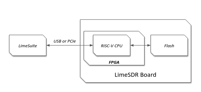

This section describes the process for updating the FPGA gateware (bitstream). Updates focus on flashing the bitstream to non-volatile storage (Flash), enabling the FPGA to load it automatically on power-up. The soft CPU firmware handles update commands from the host, with LimeSuite as the primary tool for managing the process on the host side.
Overview
Firmware updates use the host interfaces (USB or PCIe) to transfer bitstream data to the soft CPU firmware, which then manages writing to Flash. This ensures updates are persistent and reduces the need for volatile loads. Key concepts include:
  • Firmware Role: The soft CPU (e.g., VexRiscv) acts as an intermediary, processing host commands to erase Flash sectors, program pages, and handle data integrity.
  • LimeSuite Communication: The host tool (LimeSuite) initiates updates, sending commands and bitstream data in segments over the interface, with firmware responding with statuses (e.g., success or error).
  • Multiboot Support: Allows multiple bitstream images in Flash (e.g., a reliable “golden” image and an update image), with automatic fallback on failure for recovery.
  • Portability: LiteX abstracts Flash access (via LiteSPI), making the mechanism consistent across boards and FPGA vendors.
This approach minimizes risks during updates and supports shared firmware across all LimeSDR variants.
Update Process
Updates are typically performed using LimeSuite (e.g., via LimeUtil –update or GUI features):
  • LimeSuite connects to the board over USB/PCIe and sends update commands along with bitstream data in segments.
  • The firmware receives these via control endpoints, validates the data, erases relevant Flash areas, and writes the bitstream.
  • Additional handling for non-volatile data like VCTCXO DAC values or serial numbers, stored in specific Flash offsets.
For USB-based boards (Mini V1/V2), this uses FT601; for PCIe (XTRX), it leverages LitePCIe.
